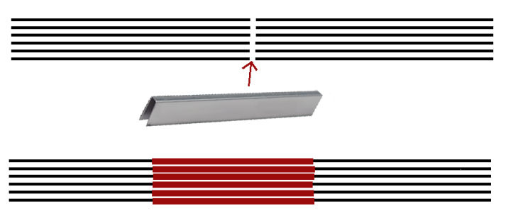

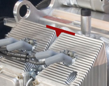

bexrbetter Posted December 10, 2014 Posted December 10, 2014 Problem is the engines dont run uniformly hot, can have rear one or two OK, and another VERY hot, without full instruments you wont even know its happening. . I'll refer this post to here .. IF ... If I was CAMit, I would be considering making 2 cylinder heads, this would certainly help with distributing temps on each bank. For the 3300 you would use the 2 cylinder heads on the 4 rear cylinders (or make a triple head). I believe this would help the throughbolt problem as well by spreading the leveraged loads. I was thinking last night of a 5 minute fix to help current Jab owners. Simple folded over lengths of aluminium pushed over the adjoining fins may be of help to balance temps by transfering heat between the heads, something like this ..... ... with the first one added ... 2 1
kgwilson Posted December 10, 2014 Posted December 10, 2014 Interesting concept. It should have some effect at least. Presumably you would put 21 of these between cylinder heads to connect all fins, so 42 per side, total 84. Would a push on fit be good enough so they wouldn't come off through vibration? The number per side is good (See Athiest thread) as it is the answer to life the universe and everything. 1 2
bexrbetter Posted December 10, 2014 Posted December 10, 2014 Would a push on fit be good enough so they wouldn't come off through vibration? . Maybe a small hole in the middle of them all and run a tie down wire through the lot, there should be enough room between the heads for that. Maybe even use perforated aluminium to let a bit of air flow through as well. I'm sure there's a few other ways to figure it as well. Presumably you would put 21 of these between cylinder heads to connect all fins, so 42 per side, total 84. . If they were a bit thick and it was felt it was preventing air getting down between the heads then you might want to do every second one only which would then be a grand total of 42 and all the Worlds problems would be resolved.
Old Koreelah Posted December 10, 2014 Posted December 10, 2014 Bex I was about to ask if you had a patent on that modification. Then I had a think. (Takes a while.) The hottest area of the head is the outer part around the exhaust valve, so it might help the middle heads of a six, but on a four it would likely have no effect, other than restricting airflow. Edwin Land held heaps of patents, including for Polaroid photography. When asked how he came up with so many winners he said that he just had a lot of ideas- and tossed out the bad ones.

bexrbetter Posted December 10, 2014 Posted December 10, 2014 The hottest area of the head is the outer part around the exhaust valve, . Yes, and that heat travels throughout the entire head, i.e. conduction, and will travel via the BMDCS (Bex Microscopic Diffusing Conduction System™, Patent Pending) to the connected cooler head. My point was to help balance the temps between the heads, not to change them per say. Bex,Jab had until about 5 years ago added what they called "Gull wings" between cylinders. A piece of aluminium sheet that connected to each head with adhesive. They recommended to remove same, probably after the newer heads. Phil. Very respectfully, don't care, I'm one of those people who listens to no one and makes my own discoveries. This is a "5 minute mod" with no permanent alterations to the engine, doesn't work throw it away, what's to lose?
kgwilson Posted December 10, 2014 Posted December 10, 2014 Bex,Jab had until about 5 years ago added what they called "Gull wings" between cylinders. A piece of aluminium sheet that connected to each head with adhesive. They recommended to remove same, probably after the newer heads. Phil. The "gull wing" baffles are still included in the ram air duct installation manual for 6 cylinder engines but Jabiru no longer supply them with the engine. The idea from Jabiru is to force air through the head fins rather than between the cylinders. Jabiru specify these should be on the top. Gull Wing baffles have been around for years and are on many Lycoming & Continental engines but are always on the bottom. This allows air to flow down between the cylinders & then be forced sideways to get some air flow over the cylinder fins at the bottom. This seems to me to be a more sensible approach than the Jabiru one. I have not installed them but will monitor the situation once my aircraft is flying. 1 1
kgwilson Posted December 10, 2014 Posted December 10, 2014 Gull wings are standard with CAMIT engines and they are larger than the Jabiru ones were. Are they on the top or bottom?
