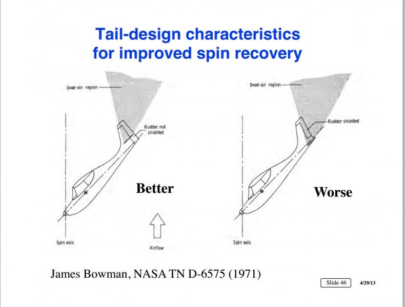

djpacro Posted July 18, 2013 Author Posted July 18, 2013 Yes, the Decathlon (and Pitts) will neatly transition to an inverted spin if opposite rudder is applied along with brisk full forward stick. Direction of roll stays the same but direction of yaw is reversed. Quite disorientating. As for moving the stick forward alone, here is part of the short story. Refer to the attached picture. The grey shaded area is "dead air" so the parts of the fin and rudder in there are not effective. Fin and rudder in clear air provides resistance to the spinning motion (roll and yaw). Enough rudder outside that blanketed area is also required to be able to recover from a spin. Consider the tail configuration on the left. Something like the Decathlon and Pitts. Move the stick forward, elevator moves down and increases the "dead-air region" so that more of the rudder is blanketed. Less resistance to spinning so the rate of rotation increases and gyroscopic moment pitches the nose up. Nose down pitch steepens the spin but remains stalled because of the nose up gyroscopic moment. The "ballerina effect" of the reduced radius of rotation also increases the spin rate. With the reduced rudder effectiveness, if opposite rudder is applied in an attempt to stop this accelerated spin: recovery will take longer or it may not recover at all. Now consider the tail design on the right with the horizontal tail moved further aft as for the CT-4, Chipmunk and Zlin 242. The "dead-air region" is moved back behind the rudder. Moving the elevator does not have any effect on the effectiveness of the rudder. The two tail designs can be grouped together approximately wrt control actions for spin recovery (without discussing Beggs- Mueller technique right now). 2

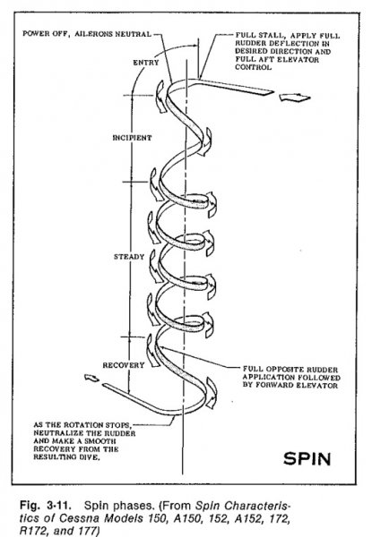

motzartmerv Posted July 18, 2013 Posted July 18, 2013 Excellent , thanx Dave. It's interesting stuff. Is the diagram accurate with the spin axis being so far forward of the cofg?
djpacro Posted July 18, 2013 Author Posted July 18, 2013 Appearances can be deceiving - imagine that pic superimposed somewhere on this diagram: Longer answer here: http://www.flightlab.net/Flightlab.net/Home_files/10_Spins.pdf 2

Mick Posted July 21, 2013 Posted July 21, 2013 Dave, would the effect you describe in post #5 with dead air be as pronounced in an aircraft with the entire elevator ahead of the rudder such as a Cap 232 and most of the Mundry series?
djpacro Posted July 24, 2013 Author Posted July 24, 2013 I don't have first hand knowledge of the CAPs but the likely extent of the interference can be obtained by drawing the areas similar to that NASA diagram above - draw the lines for different elevator angles to give some indication of the potential reduction in rudder effectiveness. The CAP series has a very large area of the rudder below the elevator therefore in clear air.
