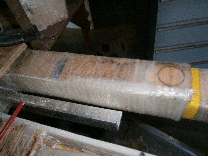

Garry Morgan Posted November 15, 2013 Author Posted November 15, 2013 Hi David, A glider with a retractable fold away motor , as the 18m single seat will need a GFA rego and membership Form two inspections. As for the touring motor glider which has a fixed motor up front as a normal powered aircraft can be registered RAA SAAA GFA or CASA 1
Garry Morgan Posted November 22, 2013 Author Posted November 22, 2013 After much thought on the wing skin finishing and the work needed, also the ageing shrinkage problems, and to get the constant strength in carbon fibre ( for the home builder) and the( buckling )cost which isn't to bad. A spar made of S glass, making foam ribs, just bolt a timber pattern each end and sand to shape. Make a leading edge, it is easy to bond a metal skin over it. This would save many months of sanding, which will shrink in a few months. 1

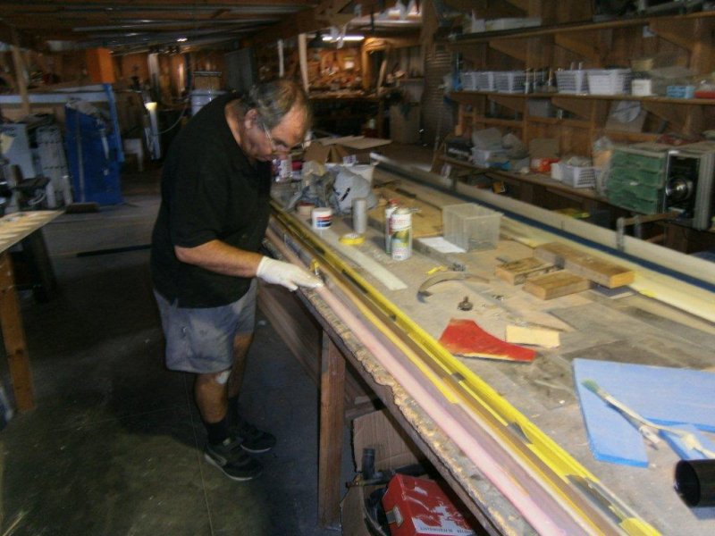

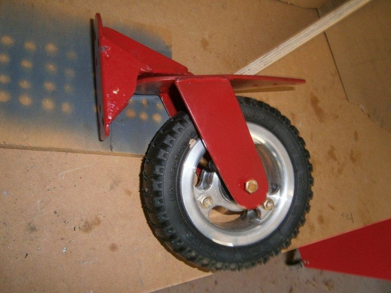

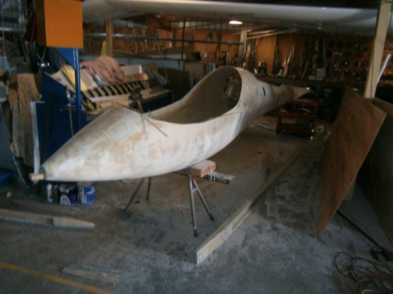

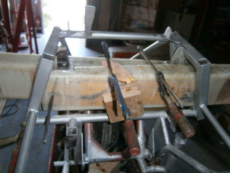

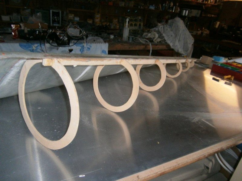

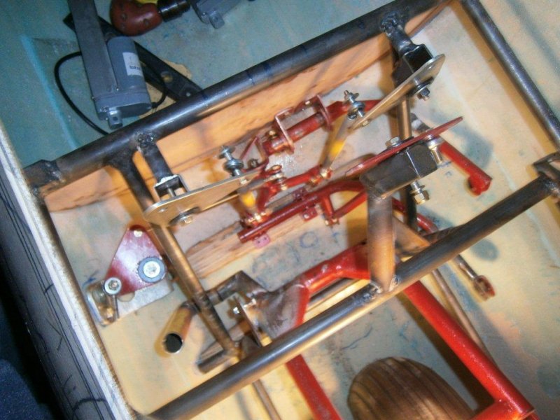

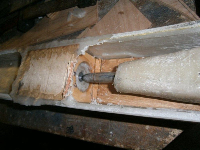

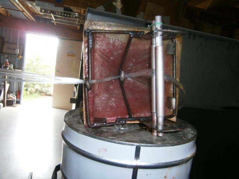

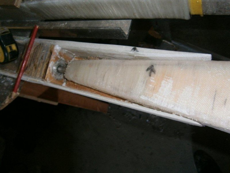

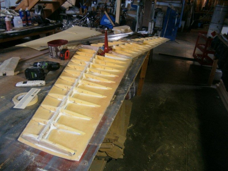

graham brown Posted August 8, 2015 Posted August 8, 2015 Hi Garry asked me to post some pictures of his new fibreglass motor gliding he is building (the Shawnee). 1 1

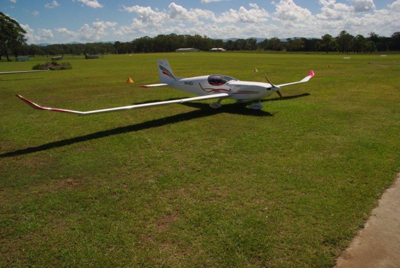

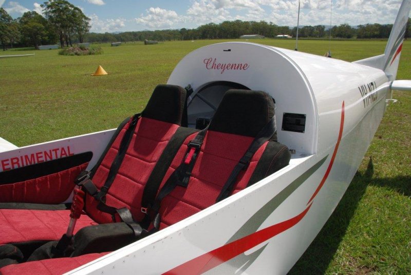

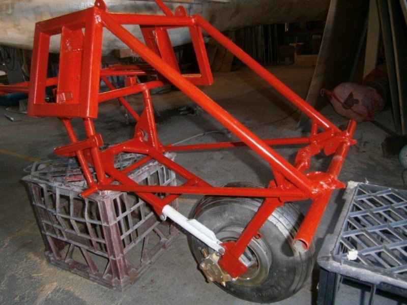

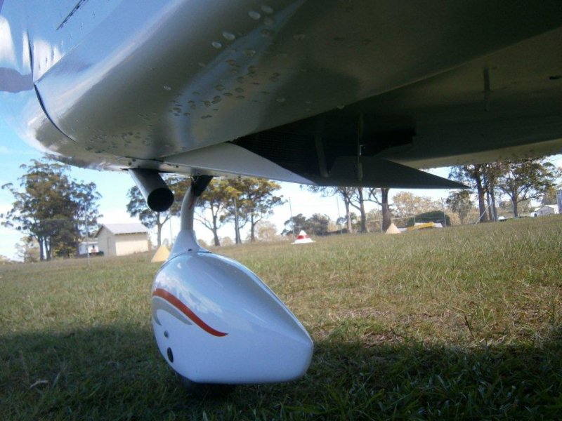

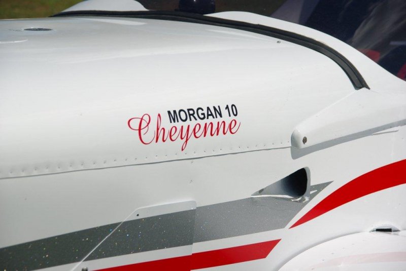

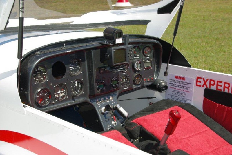

graham brown Posted August 8, 2015 Posted August 8, 2015 Also posting the pictures of Garry's Cheyenne touring motor glider. 5
