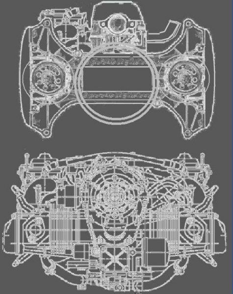

So will the bexmetter fit in a 912 cowling?
Very rough schematic comparison ... mine is 500mm wide, Rotax is 575mm.
That is a standard, modern, 'sold in the millions' SOHC 2 valve head sitting on top, available worldwide as are head gaskets etc. I've mentioned before that it's not just a cheap engine to buy but more importantly will be cheap to own long term. I wanted to go DOHC and 4 valve but there is certainly a resistance with flyers to move forwards too quickly.
Note that the water cooling on mine is centralised, ie; the head and immediate block under it, and eliminates the need for mutiple connecting pipes as the Rotax needs to use.

Very rough schematic comparison ... mine is 500mm wide, Rotax is 575mm.That is a standard, modern, 'sold in the millions' SOHC 2 valve head sitting on top, available worldwide as are head gaskets etc. I've mentioned before that it's not just a cheap engine to buy but more importantly will be cheap to own long term. I wanted to go DOHC and 4 valve but there is certainly a resistance with flyers to move forwards too quickly.
[ATTACH=full]22503[/ATTACH]
Bex depending on the rpm range there would be little advantage in double overhead camshafts and 4 valves just a weight disadvantage.
