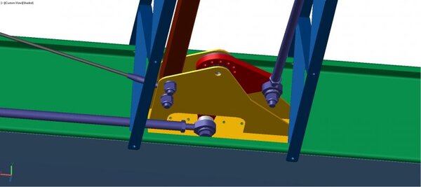

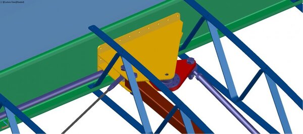

Re your post HITC, you may already have these things in hand but its worth mentioning them:
1. The vertical stabiliser is shown at various heights in different sketches. After being terrorised with no rudder or directional stability in one RA around the flare point as the tail sinks, I'd like to see the vertical stabiliser as high as possible to minimise blanking by the wings.I think rudder authority is more critical in RA than a GA aircraft because of the lower critical mass.
2. Have you done any serious mass distribution calculations? I can see what you are getting at with the configuration, but the engine CoG moves quite a way back compared to conventional side by side aircraft.
3. I've done a lot of work designing and building space frames, and usually find I've forgotten triangulation in some areas, and other areas need supplementary strength, such as the leg area. I'd recommend an early balsa matchstick type modelling of the frame where you can instantly feel any flex and see the concept in three dimensions without the hours of CAD work.
I think we're seeing the cost limitations of trying to build cross country aircraft with prices climbing towards new Cessna costs, hangarage escalating etc, so trailerable is beginning to look like a strong market possibility. When you can do the long legs to a point of interest in any weather/headwind in a car and trailer everything becomes simpler, and under those circumstances the high cost of 80 < 100 hp is also not essential for many people who want to look at scenery, or just fly.
This would not be sold into the mass consumer market, so a name is not so critical. The truck Industry uses designations like T600, FSR 900 LONG, CT610 etc so C2S would be market appropriate.
Yes, though I'll probably never remember those names but I'll certainly never forget the magnificent old 1970s SuperSpace Longliner 69er with twin Gobsmackers banana.gif.9fb7816a43624add5d39667894cbde9a.gif
Seriously though, I do see your point Turbs, if the meaning of C2S was publicised it would become very easy to recall.
I think it should be called "Altocumulus Lenticularis"..Or "Bob".
Reminds me of way back when Charles Ligetti was working on a name for the Stratos. We were at Essendon Airport having just visited Ross Nolan at Slipstream Aviation. Charles suddenly ejaculated (verbally OK?) "Stratos!". Sander Veenstra said "No bloody way, if you do I'll call my next one Alto-Stratos" but Charles did and in the end Sander called his Farm Mate instead.
Re your post HITC, you may already have these things in hand but its worth mentioning them:1. The vertical stabiliser is shown at various heights in different sketches. After being terrorised with no rudder or directional stability in one RA around the flare point as the tail sinks, I'd like to see the vertical stabiliser as high as possible to minimise blanking by the wings.I think rudder authority is more critical in RA than a GA aircraft because of the lower critical mass.
Valuable feedback Turbs, thanks.
Using your order -
1. I hadn't noticed the different heights but the fin will be as high as the engine (max height for getting it into a shipping container, to allow them to be used as cheap hangars) and that gives a VS volume of 0.6 which is about 12% higher than what Raymer considers quite acceptable. Even so I love crosswinds and I consider the rudder to be my most important control surface (yes, I had very early days primary training) so if there's any lack of authority in any part of the envelope revealed during testing there'll be changes made to fix it.
2. Not yet, only basic ones until I've finalised all the structural members and run the numbers on the weights. The weight distribution is tricky, it being so short and with such a high CG, which is necessary to get it short enough when folded, for container or trailer.
Having that high CG has been a bugbear all along because during the landing, or at any time at high alpha, the CG moves back just when the CP is moving forward, so I'm trying a bit of trickery with the decalage to keep the pitching moment change reasonable or I'll be limited to a fairly forward CG requirement, or there would be a risk of pitch instability at high alpha. I'm going to test with a Clark Y due to its good lift co-efficient and progressive stall but may have to go for a semi-symmetrical if the CP proves to be too mobile.
If the stall speed at MTOW is low enough (I can't calculate it accurately due to unknowns about the biplane interference) then I may consider having two settings for the elevator. The more limited one would suit the less experienced and make the plane stall-proof and spin resistant by having insufficient authority to bring the mainplanes to a progressive stall (the Ercoupe principle) and the second setting for experienced flyers who can make good use of, and manage, minor instability.
The high CG has also given me strife with the main gear placement. I allowed it to tease me into believing I could use the strong point of the rear spar attach to run the gear leg through which was perfect structurally and saved some weight. So I got a fixation about that for a while but have now accepted it'd be too far aft and make the nosewheel weight too high and likely to dig in, not to mention the ka-slap potential for landings ...
3. Yes, it's virtually impossible to fully triangulate everywhere if you also want to fit a human or two inside. The younger generation don't seem to object to things through their belly-buttons but most of the flyers I know would take exception. In some places the triangulation has to be replaced with good moment connections instead.
