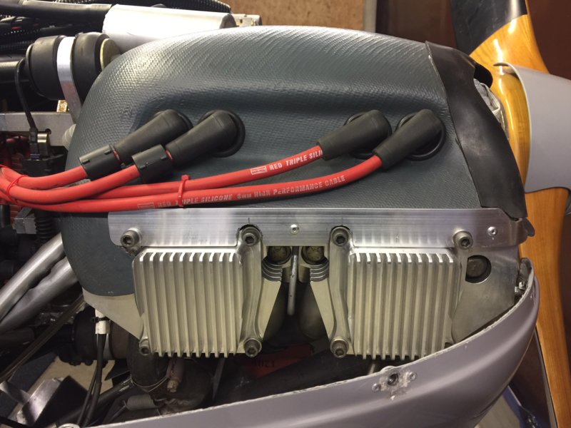

these TOCA are specially built for the jabiru with alternative thermostats (I have a 83 deg C) all dependant on the version of the engine you have, I bought mine from Kev Hyam ([email protected] uk tel no: 07415 494717) who will recommend the thermostats you need subject to engine type, but they are actually made by Steve Rance ([email protected]) who makes lots of other wonderful goodies (see attached photo) The TOCA UK BMAA approval is. minor mod approval number 1498 part 2. it is also approved by the LAA
