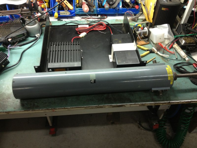

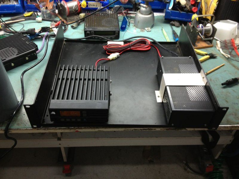

Kyle Communications Posted April 9, 2013 Posted April 9, 2013 The bandpass cavity arrived from my mate down the Gold Coast this afternoon. I will see if I can get it installed later this week or on the weekend. A couple of pics to show the unit in the rack tray and the size of the cavity Mark
