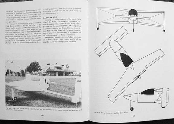

Guest Maj Millard Posted August 7, 2013 Posted August 7, 2013 One design that I really liked was Caig Catto's Acro X....it was an outgrowth of the Cunard Goldwing. Similar fuselage as the Goldwing with the same Cunard and an enclosed streamline canopy. Instead of the single low swept back wing, the Acro X had two shorter wings in a biplane arrangement but they were joined at the tips with vertical surfaces incorporating rudders. The top wing had a large degree of dihedral, and the lower wings a high degree of anhedral, hence the X in form. Closest comparison was Luke Skywalkers fighter plane in Starwars. As far as I know only one was made using the same glass over foam construction as the Goldwing, and I believe Craig flew it to Oshkosh about the same time the Legiti Stratos was shown there. It was lost shortly after his return to California when the bubble canopy flew off and caught in the cross bracing in the wings, causing considerable drag on one side. Craig fortunately that day was wearing a parachute, and was forced to use it. I remember him saying it just ended up as broken bits of blue foam !......It offered good speed, an almost unbreakable structural design, and increadably striking and modernistic good looks.............Maj...
winsor68 Posted August 7, 2013 Posted August 7, 2013 http://eaaforums.org/attachment.php?s=259e46240d556c6b751d31a7bfa5b22a&attachmentid=3130&d=1374681562
Guest Maj Millard Posted August 7, 2013 Posted August 7, 2013 Yes that's it Don. The nose wheel retracted like the Variezys, and it looked very slick in the air ..thanks...........Maj...
Guest Maj Millard Posted August 7, 2013 Posted August 7, 2013 Thanks also corvairkr....hell, let's just build one !.....................
