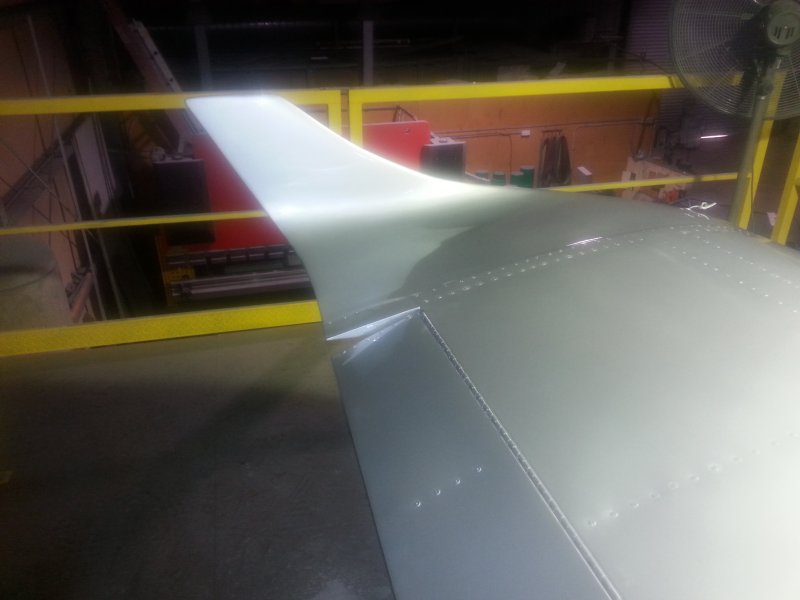

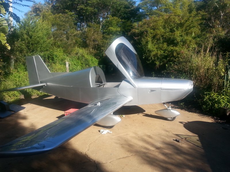

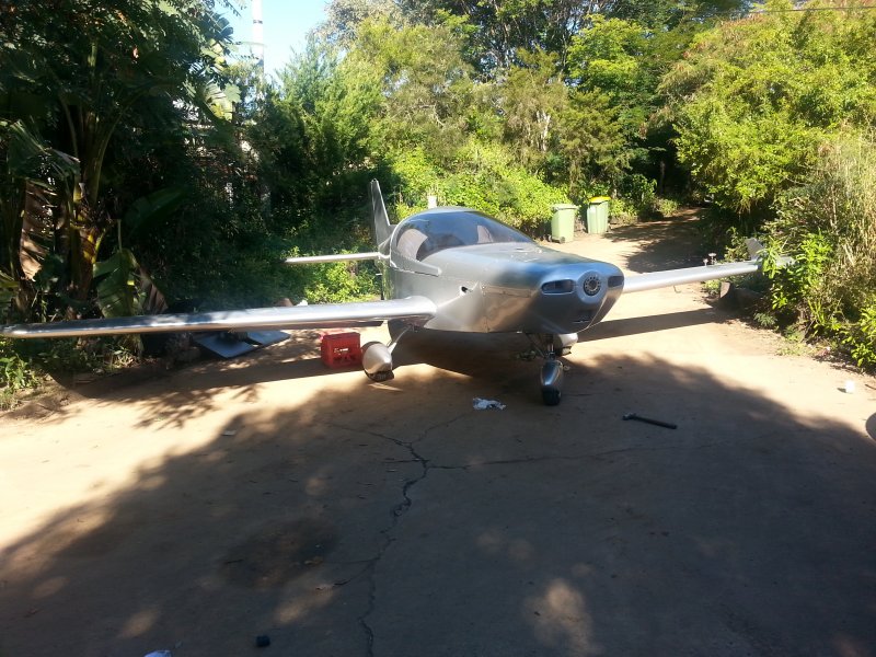

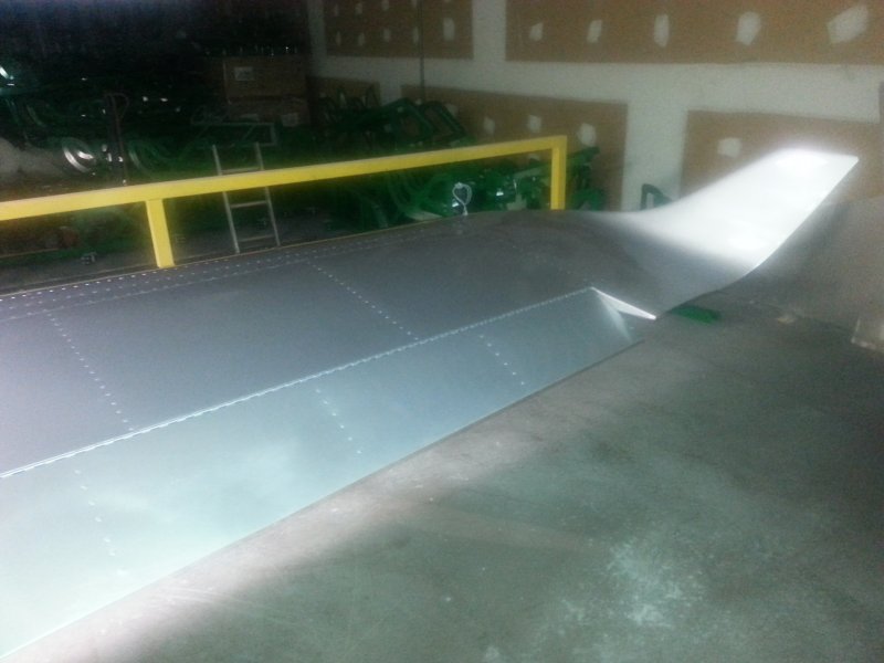

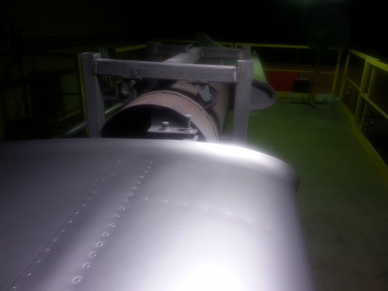

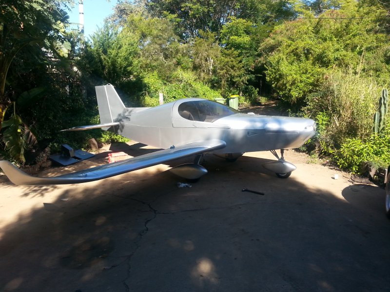

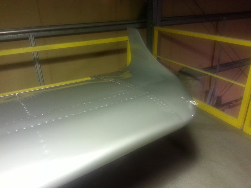

More pics of finished wings all painted ready for decals, fuselage is being readied for painting we did the strip down on saturday craig will be painting this week
cheers Gareth & Craig
Thanks John
when we fitted the wings ,we never liked the finish with a rubber to the fuse ,we used foam to form up the flare and sanded back to the shape then fibreglassed over ,a lot of work but the result was a good line to the fuse
cheers gareth

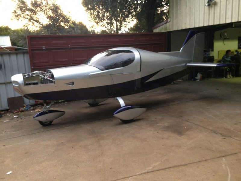

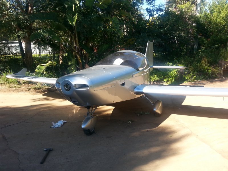

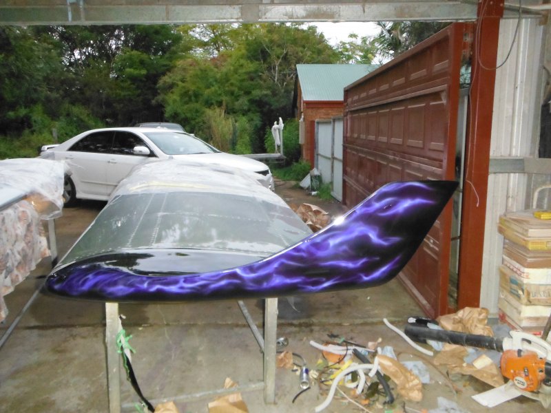

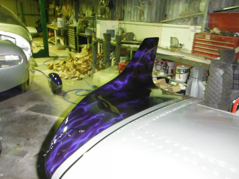

Thanks Mark ,here is the plane finished painting and wings on spats brakes engine electrics battery in brake lines in rudder elavator trim system all in ,all bolts locked and pin marked as a final inspection hatch in and wired final decals /airbrush work later still waiting for prop from the states
interior trim is being worked on
cheers gareth

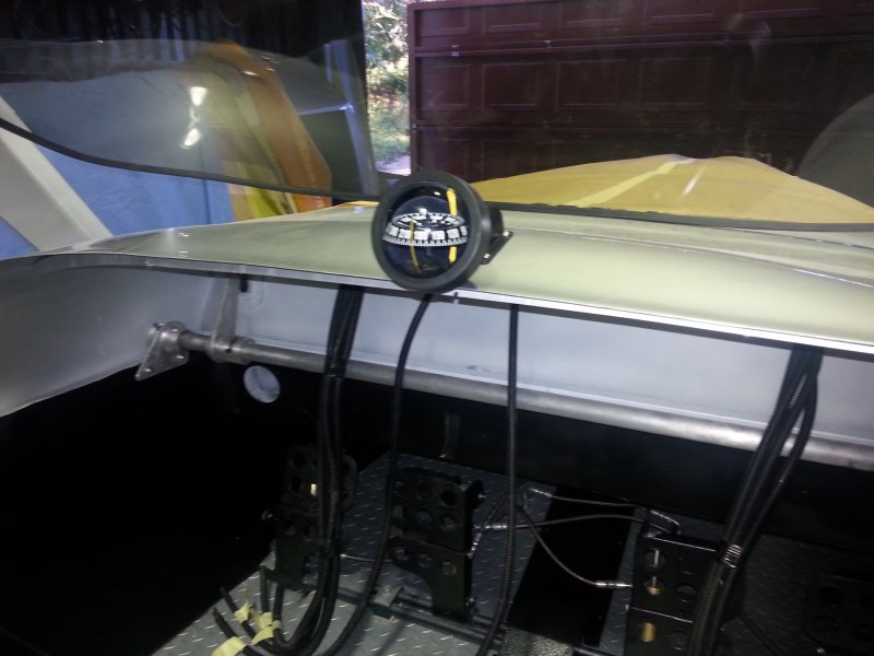

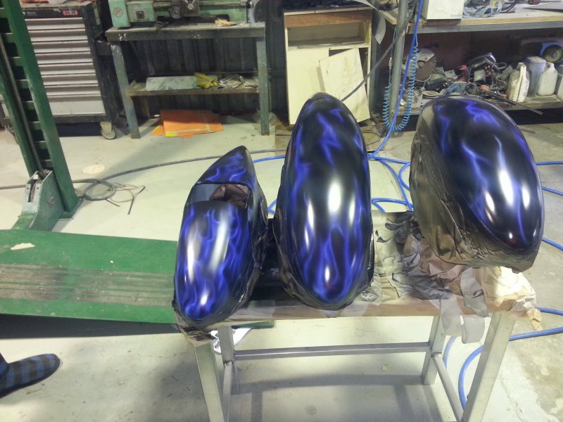

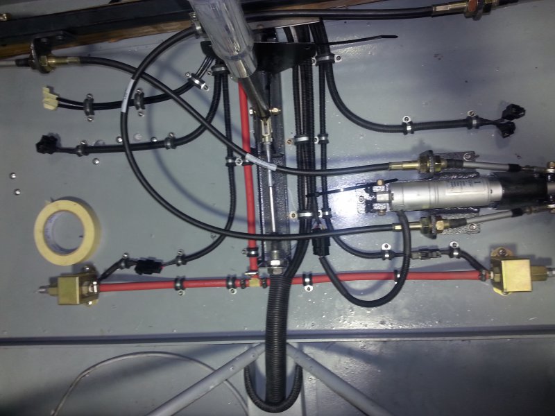

More Progress

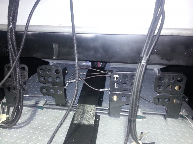

fuel transfer pumps in and connected , flap actuator wired in and connected all electrical wiring in through to dash area brakes system in and working rudder and brake pedals in, floor covering in ,seating is finished an interior trim all finished (leather) all paintwork finished and air brush work is being completed this weekend , numbers go on next 19-8335 prop arrives next week (fingers crossed) spats painted with graphics
cheers Gareth
Can't wait to see it painted.. Wheel spats graphics look awesome..

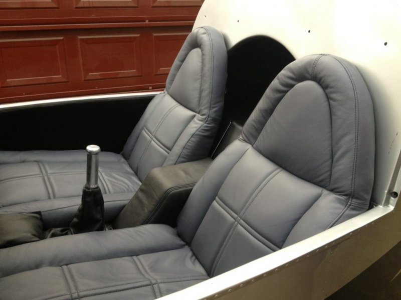

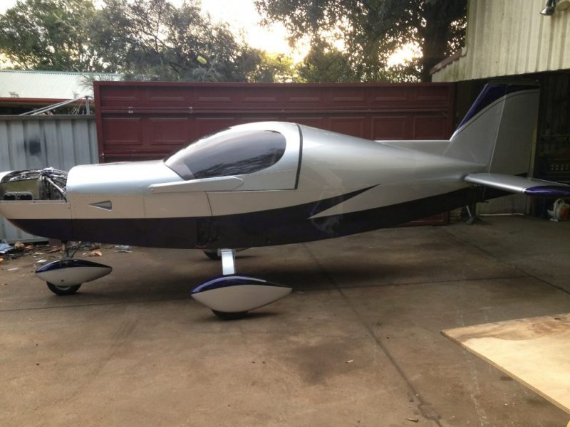

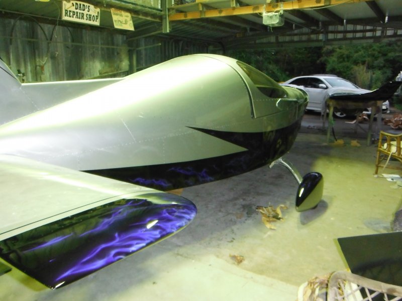

anyway a couple of more pics paintwork complete and seats fitted
cheers Gareth& Craig
Thanks John ,we did go for comfort for the long trips (to aldinga next year?) I have been flying a Jab 170 and i get a sore axxse after 1.5 hrs so comfort was a critical thing for us oldies LOL ,its so close to being finished I can taste it !!
