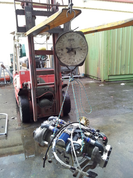

here vis the UL 130 engine just arrived and the engine weight 70 kilos ,no oils or fixtures ,all parts in box 5 klilos
Looking good.... 155 lbs with all that hp....... it's going to be a rocket ....107_score_010.gif.2fa64cd6c3a0f3d769ce8a3c21d3ff90.gif

Hi allhere vis the UL 130 engine just arrived and the engine weight 70 kilos ,no oils or fixtures ,all parts in box 5 klilos

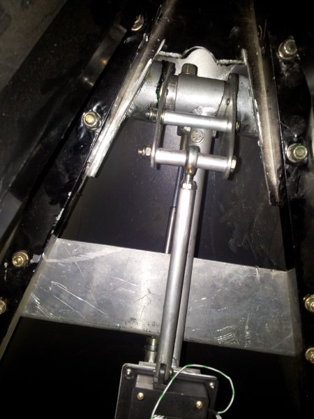

a few pics of progress:
at the moment wings are off being sanded and coated engine mount will be fabricated and engine fitted
391961047_trimmechanicsonbalancearmforelavator.jpg.d1c1fae7e4d4e4bd87cf054466dc113a.jpg

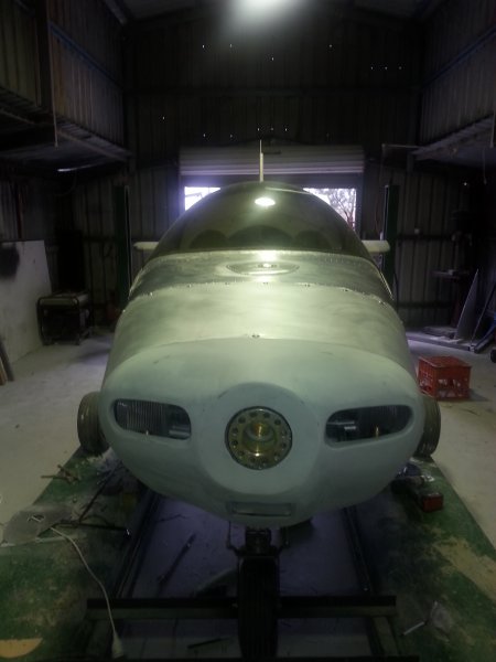

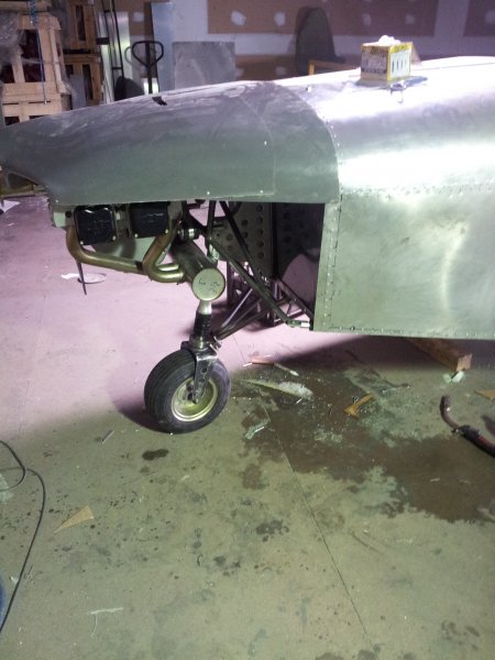

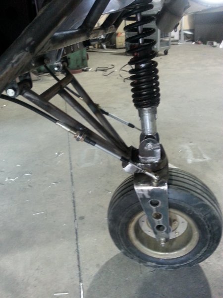

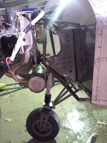

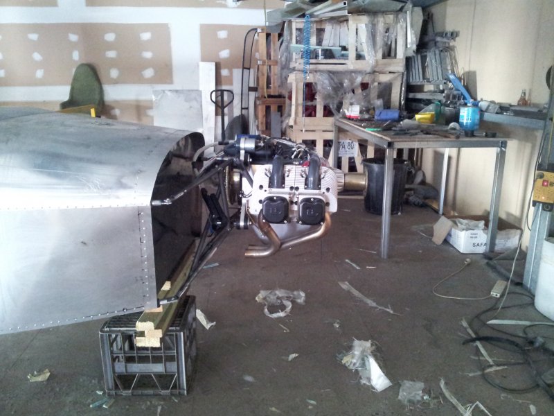

a couple more pics
1 completed steering nosewheel with control cables fitted
2 mock cowl fitted

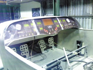

Hi All
here is the final layout of our dash : note dual flying glaps and trim and throttle

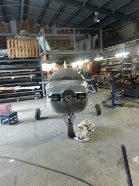

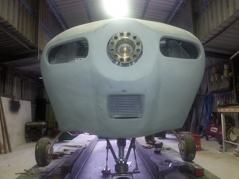

back again

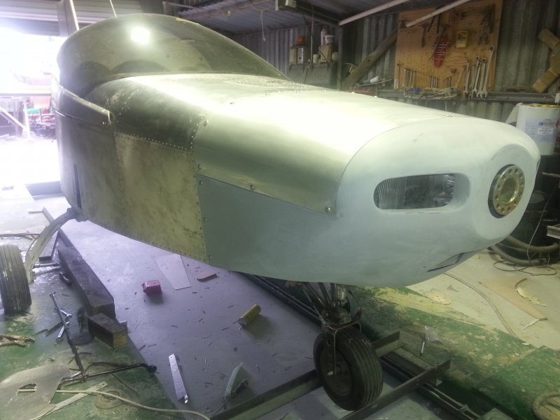

we have made the top of the cowl alum for easy removal, bottom of cowl was Garrys fibreglass cowl but we had to cut and shut it to fit
sides of fusalage at firewall is removable both sides this gives us complete access to brakes ,fuel pumps steering mechanics, tank fittings
next week start preparing for painting , avionics are being wired and the upholsterer will be starting cabin fitout
Cheers gareth& Craig
back againwe have made the top of the cowl alum for easy removal, bottom of cowl was Garrys fibreglass cowl but we had to cut and shut it to fit

I see the lower cowl is attached to nose bowl ,bad move as you will need to remove prop to service engine,have modified several cowls to overcome this oversight
Mick W
Re you tail trim tab, is it an 'Anti Servo Tab' or simply an adjusting tab?
