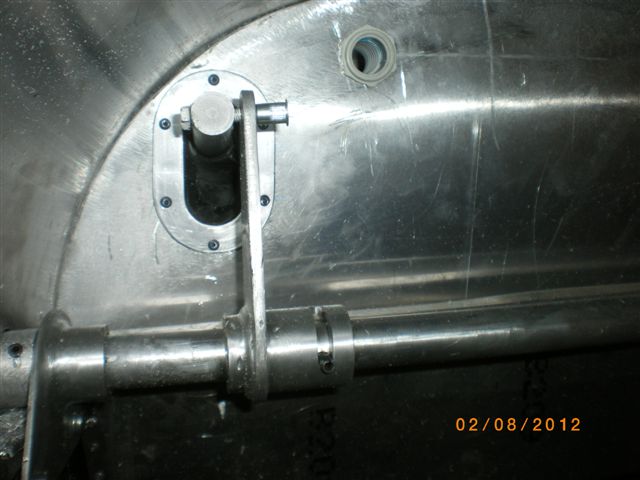

pic 2 is actuator canopy side arms

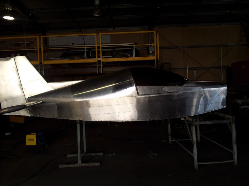

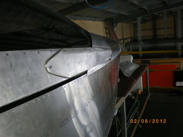

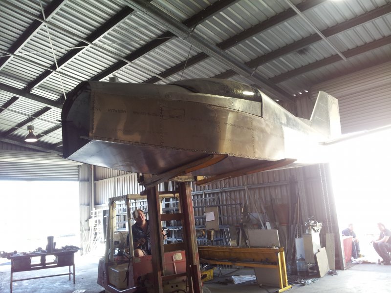

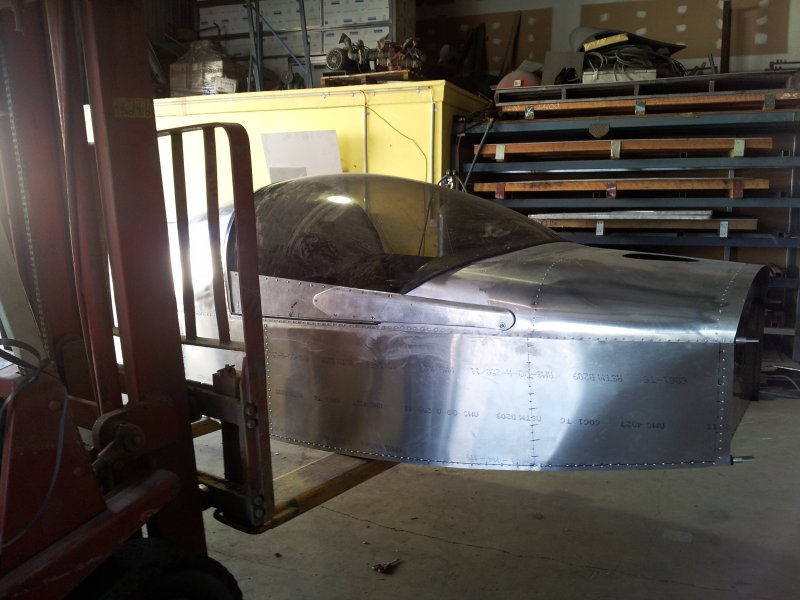

Hi all
finally finished the canopy fitting, canopy fits the bulkhead perfect,safety locking mechanism is concealed in the side canopy arms, and it is now down off the mezzanine ,starting the wing spars today below are some fuse pics

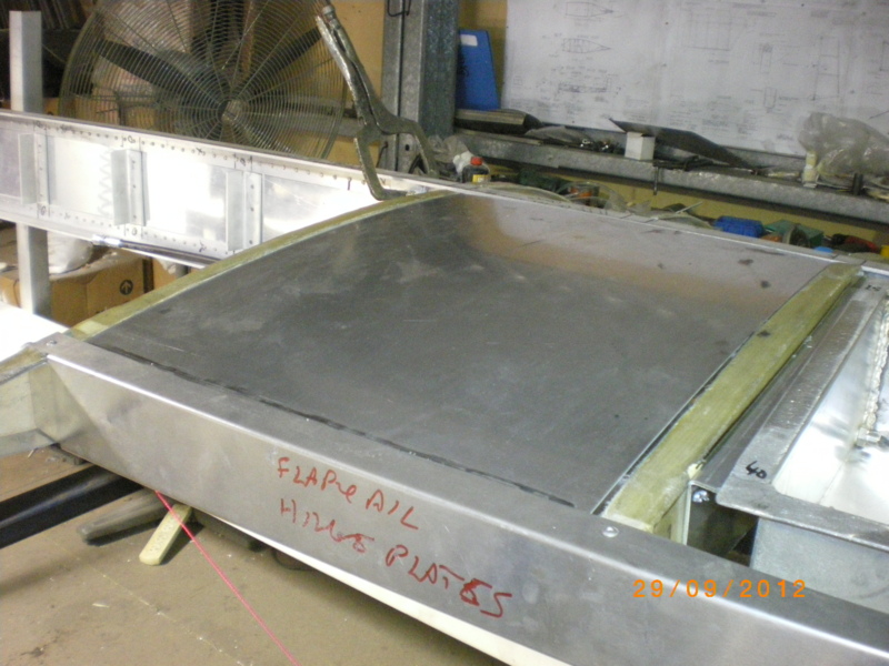

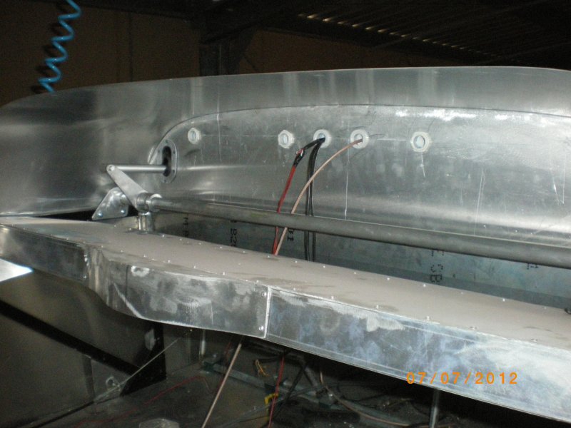

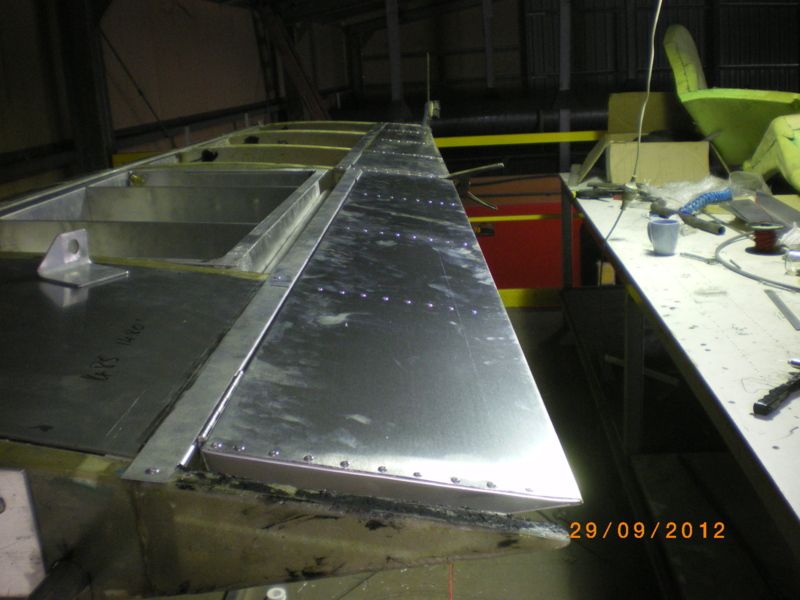

Hi all
here are a few picks of the wing /strut build for the sierra

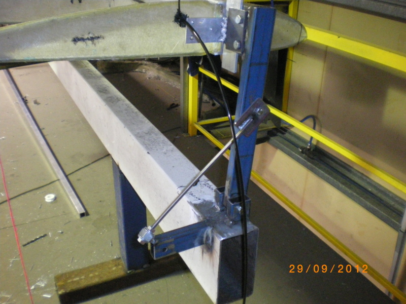

1741776669_sierrabuildwingspics006.jpg.f8b9fa49352bda71535e2e46fb0ea5ae.jpg the beam jig to hold the strut and the simple adjuster to set the washout

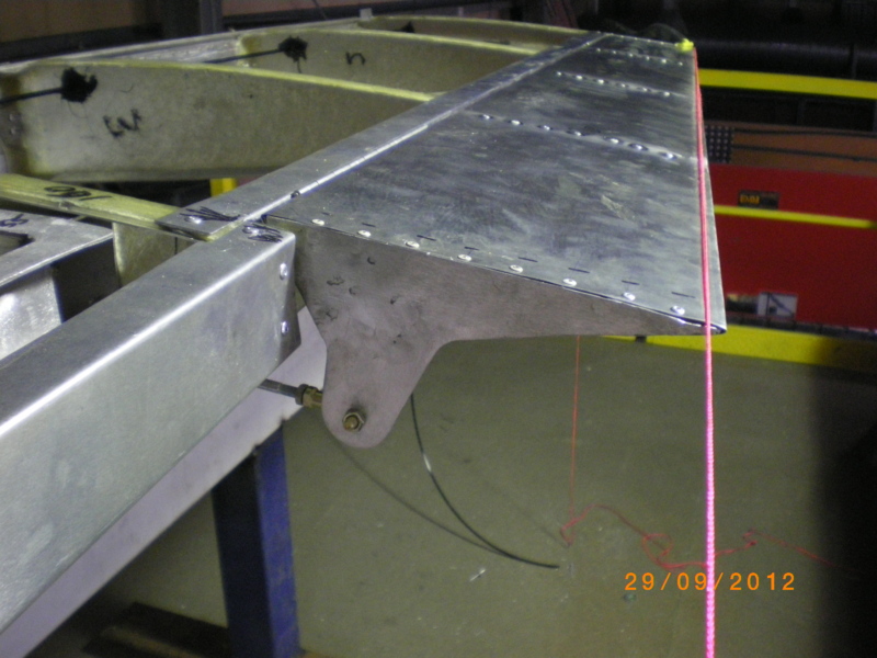

1038679662_sierrabuildwingspics002.jpg.9a48464ef6b66c2fee05324af266dc41.jpg aileron horn
1446130292_sierrabuildwingspics011.jpg.d6fc904fa8c8208341cb7373448d29b2.jpg alum wing walk/step

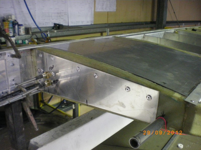

815566227_sierrabuildwingspics012.jpg.e8ba702b3bb082d9c165558f5ac71d1c.jpg flap,aileron cables through no 7 rib and fuel line
147971193_sierrabuildwingspics013.jpg.9cb9738281f7ea54b0e74d716fb39348.jpg flap and aileron fitted

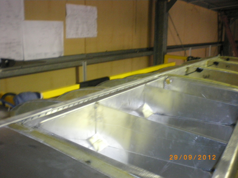

1261961873_sierrabuildwingspics003.jpg.23e4ba7e6182bf61ab62f441beeac39a.jpg alum 30 litre tank
773080222_sierrabuildwingspics007.jpg.45148c523ecf3987d4a0339d0f4a30eb.jpg tank vent pipe through to wing tip

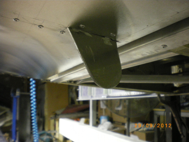

139728245_sierrabuildwingspics014.jpg.2ecad3bdca6c548bc7e396b8709cf41d.jpg control horn through flap skin(bkt is internal fixed to rib)
the alum tank and wing walk plate with stiffeners weight came to 7 kilos,offset that is less fuel ie less weight next is to skin
cheers all Gareth & CRaig

Hi Gareth
The plane is looking good. Was there a reason for going for metal wing tanks over Garry's fiberglass tanks, and did you make them? Also, did you have trouble routing the aileron cables around the tanks? We did, but perhaps your cable was longer.
