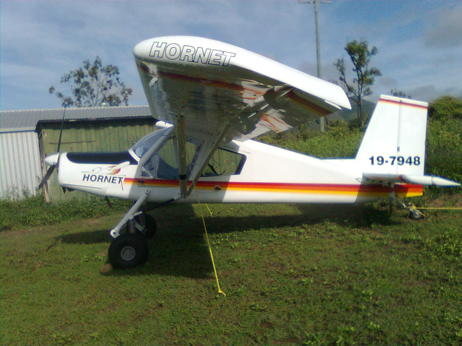

Brand new Hornet 19-7948 which arrived at Montpelier last weekend from taree, suffered an engine stoppage today and sits in a grassy field near the Ross River dam, not far from home base. Appears the pilot was switching fuel tanks enroute. From reports he turned the old tank off, and didn't select the new tank quick enough, resulting in fuel starvation to the engine. The correct proceedure by the way, is to turn the new tank on first, and then turn the old tank off !....Don't know what height he was when the stoppage occurred, or if an inflight restart was attempted.
From a flyover it appears the left undercarrage has collapsed, and there is also LH wing damage. The two occupants escaped unharmed.............................................................Maj...024_cool.gif.7a88a3168ebd868f5549631161e2b369.gif

No it was a side by side seat job with a 912uls up front. Yes it did look rebuildable from my fly-over, so the owner will have something to do with his time for a few months, yes she was brand new, and yes always good when nobody gets hurt. Nice looking machine..pity.....I have some photos of the aircraft pre, and post-crash, which I will post later this evening................Maj...
