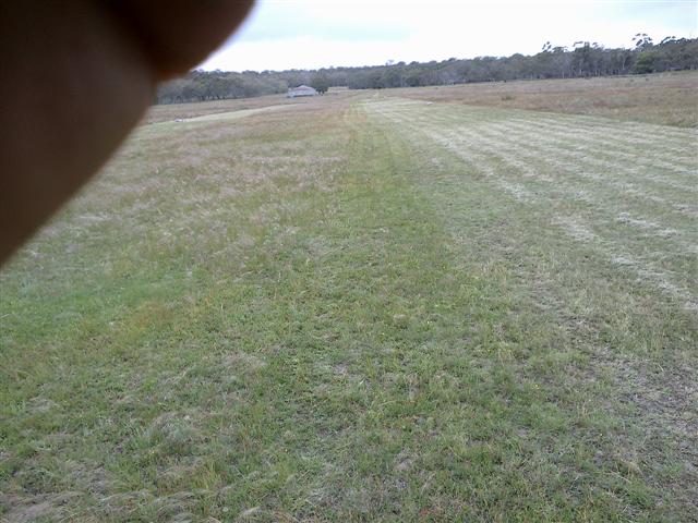

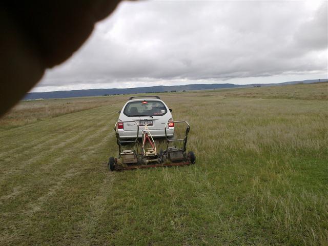

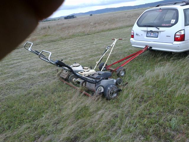

Methusala Posted December 4, 2011 Posted December 4, 2011 Faced with the perennial problem of keeping the grass strip mown to a reasonable length we tried a little ingenuity. Armed with 3 Victa mowers of varying ages and some scrap 50mm angle a plan was hatched. Canberra is very fortunate to have a government that will sometimes enable innovative community schemes to bear fruit. In the 80's a plan to utilise unemployed people to recover and sell valuable items from the tip evolved and this is the basis of a successful private/public partnership today. From this resource came our mowers, steel, wheelbarrow wheels and even a quantity of welding electrodes. Over the past 2 weekends, I fashioned a frame with wheels and a towing hitch. Mounted were the 3 mowers which run simultaneously and cut a swathe about 1300mm wide. Towing speed is about fast walking pace and the resulting cut is almost as good as a tractor mounted slasher. Of course the noise is fearsome but satisfyingly all 3 mowers ran for the 2 hour test run. Fuel consumption is about 1l/hr per mower.The total materials cost was about $100 and the hourly rate was absorbed into the aerodrome enhancement reserves. This was a satisfying project and fairly easy to build. I encourage those with a similar problem to benefit from this successful experiment. Cheers, Don 2
Methusala Posted December 4, 2011 Author Posted December 4, 2011 A small step for mankind...but a huge one for me, Don
