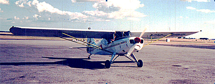

coloc22 Posted February 9, 2014 Posted February 9, 2014 hello I want to share a picture of our auster with lycoming o320 108 hp. The speed is around 100 mph. 2

kaz3g Posted February 9, 2014 Author Posted February 9, 2014 hello I want to share a picture of our auster with lycoming o320 108 hp. The speed is around 100 mph.Very pretty, Coloc...who did the 0-235 conversion and what did it have originally? Kaz
