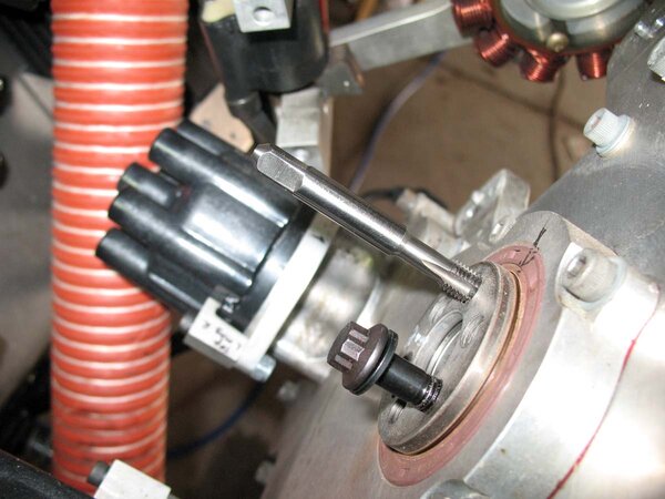

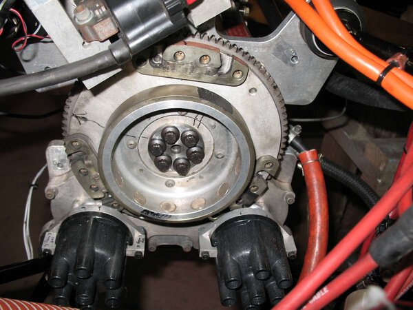

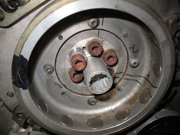

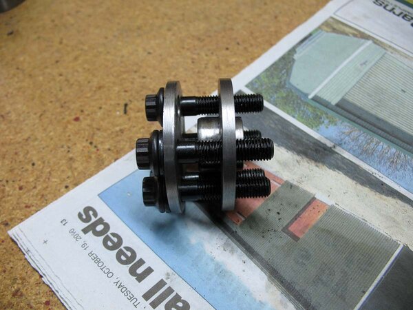

gregv Posted April 27, 2011 Posted April 27, 2011 I've asked plenty of questions of late, and added little. Thanks for the helpful comments from members of this board. All have been very helpful in the top end rebuild process I am now near completing. I thought I'd post a few photos of the flywheel spacer modification I have used. In short, my assessment is that flywheel bolts break because the 'friction joint' between the crankshaft, the ali spacer and ali 'flywheel' gets loose and the bolts subsequently get stressed and break. Maintain the friction between the parts by maintaining bolt preload and the problem is solved. Dowels won't stop this from happening. The new steel centred 'starfish' flywheel on newer engines removes the relatively soft aluminium centre which the flywheel bolts tended to recess into, losing their preload and loosening the sandwiched parts. Old flywheel centre is pictured below with Unbrako 5/16" 1-1/4" long cap screws tighened up against the ali flywheel. Two were loose, and all were recessed into the flywheel by up to 0.3mm.  I machined up a steel replacement spacer, but dispensed with the vacuum drive extension. I also machined a 4.5mm steel disc, and replaced the bolts with ARP brand 5/16" 1-1/2" long bolt (to counter the new compression disc and provide a few more threads into the crankshaft). The crank bolt holes were cleaned out and checked for adequate depth.  Replacement steel spacer with compression disc and new bolts  The aluminium flywheel is now sandwiched between two steel discs. The bolts are spec'ed to to tightened up to 50+ft/lbs into steel. We settled on 45ft/lb as a compromise figure.  With the vacuum pump drive no longer sitting in the hole in the alternator spider, I can use a mirror to check the witness paint on the bolt heads during regular inspections. This idea was developed by a local Jab owner who generously spent many hours with me going through the rationale for why these bolts break and how he thought one could prevent it - basically get rid of most of the soft aluminium in the sandwich of parts. We'll see how things go... Greg v  2
kgwilson Posted April 27, 2011 Posted April 27, 2011 The rationale appears sound and as the later models are modified to steel (it would appear) to overcome this problem I reckon you are on to a winner here. Time and well documented regular maintenance checks will be the judge. Kevin Â
ianboag Posted April 27, 2011 Posted April 27, 2011 The rationale appears sound and as the later models are modified to steel (it would appear) to overcome this problem I reckon you are on to a winner here. Time and well documented regular maintenance checks will be the judge.Kevin And a few months ago, a 230 owned by the NZ Jab agent blew its bolts. It was about a year old. Engine had the new starfish thingo. That was not long after his 120 broke a through bolt, threw a pot and trashed the engine. These little things are sent to try us ...... Â
gregv Posted April 27, 2011 Author Posted April 27, 2011 And a few months ago, a 230 owned by the NZ Jab agent blew its bolts. It was about a year old. Engine had the new starfish thingo. That was not long after his 120 broke a through bolt, threw a pot and trashed the engine. These little things are sent to try us ...... Hmm. The 230 breaking its bolts in Tauranga was a new one wasn't it? Well, lets hope the ARP bolts live up to their advertised specifications...(ARP #741-1500, nominal tensile strength 180,000psi). Grade 8 bolts are supposed to be minimum 150,000psi tensile strength, with something like 60% of that used to compute shear strength... I've done what I reasonably can to minimise the risk of flywheel breakage without replacing the entire flywheel assembly. I'll post any problems that either engine with this mod develop - call it a study where n=2. Greg v Â

ianboag Posted May 3, 2011 Posted May 3, 2011 I'd be interested to see the bolts that have fractured and where they have fractured. Wonder if they have all fractured at the level of the flywheel/crankshaft interface (which would suggest shearing forces at the flywheel as Nev suggests.) They break at the interface. Fatigue - not shear - bending back and forth - not enough clamp. Â

peibo Posted November 8, 2011 Posted November 8, 2011 Hello guys I joined a coupla years ago, and have been a happy camper up to now with my wonderful Jabiru JODEL. Reading JSB012-2 got my attention tho, and led me to disassemble the back end of the engine, where I discovered fretting between the "flywheel" and the VP coupling flange, and between the flange and the cshaft gear end. Now I am in the middle of the "flywheel" bolt saga on my solid lifter 2200 SN1757 with no dowel pins nor starfish, 200hrs on the Hobbs, 400+flights. I am not inclined to remove the engine for the crankshaft dowel pin mod and associated starfish "flywheel" and thicker gear replacement thinking that the problem is mainly due to not enough clamp as you say. Had not read your thread and intelligent analyses and approaches, but came up with a very similar approach as gregv's, except for the ARP bolts (can't find em in France- do you have a link to a web store please???), and machined hard steel 3mm X 16,5mm O.D. individual washers instead of the big washer. I also did the VP drive replacement spacer out of steel 5mm X 52mm O.D. but added qty 6, 5mm dowel holes between them on dia.44,5mm drill circle which will be reamed for ground pins driven into the reamed 5mm holes in the alloy "flywheel" and new steel spacer. The clamped sandwich will be between steel parts this way with a pinned drive of the alloy "flywheel". Could you please give me your opinions, as well as the bolt link if possible, and some news of the mod you have implemented. I'm hoping to be back in the air next week. Also, any comments on crank gear cracking and failure with subsequent wall thickening by Jabiru?.. Seems to me that root cause of all of this is perhaps prop related as Jab states in their litany of reasons. My prop fretted on the prop flange despite Belleville washers, and regular maintenance. (evidenced by brick red powder -iron oxide?-coming out between prop and flange, and fretting marks on flange. My prop maker says Jab prop bushings are too short, and end up crushing the holes in a circular direction, ovalizing them and permitting alternating circular movement evidenced by the fretting. This means the FLYWHEEL effect of the prop is incomplete, and there is a deficiency in rotational smoothing which then acts at the other end of the crank upon the friction drive of the " flywheel" AND produces circular shock loading of the gear which is driving camshaft and distributor shafts with their intrinsic inertias. Perhaps this causes pulsing rotation of the distributer rotor shafts, destroying the rotors, and requiring glueing- huh? suggested by Jabiru... My prop guy suggested reinforced prop driver holes, longer prop bushings,and going from 1/4 24. Bolts to 5/16 or 8mm, and forget the Belleville washers... Could this be the answer?? Your thoughts Pierre Â

peibo Posted November 21, 2011 Posted November 21, 2011 Hello Bruce Thanks for your input. Went ahead and got my prop fixed up. Received it and the longer bushings Saturday. The manufacturer says Jab prop flange surface area is very small. Should be 85cm2 for the power..... but calculates out to 64cm2 or so..... Hope the prop will stop fretting. If not, might try to bond it like you did, or get a new flange machined with more surface area to increase friction drive. Flywheel is assembled and torqued to 40ftlb on grease. 45 seemed high...what do you think? Â
Bruce Tuncks Posted November 25, 2011 Posted November 25, 2011 Bon Jour Pierre, I reckon that 40 ft-lb should be enough. There is about 25% more clamping force for the same torque with greased threads compared with dry. It is much more than the 24 ft-lb test torque in the service bulletin JSB012-2, and heaps more than the 15ft-lb on my older engine with the 1/4 inch bolts. I reckon that loctite , not on the bolts but on the mating faces couldn't do any harm and may help prevent movement starting. If you wanted to see how much torque a bolt could take, you could also do a test on a spare bolt....see the thread on through-bolts where this was discussed. The Jabiru prop relies on the fit of the bushes as well as the friction of the flange, so I reckon your prop manufacturer has a formula which doesn't really apply. Now I need to decide what to do with my own engine. I did the check in the service bulletin, but with the loctite present, the bolts could have the problem ianboag described so well. I'm impressed with the job that you and gregv have done, but I don't know if I should do this with only 1/4 inch bolts. ...Bruce Â
