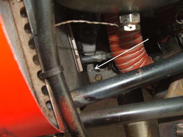

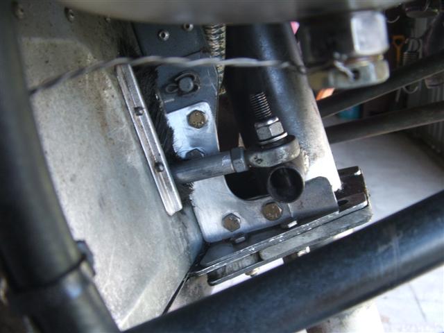

JG3 Posted April 28, 2010 Posted April 28, 2010 I have found a broken sf282 bracket as part of the nose leg support. See photo. There have been absolutely no hard nose wheel landings, but lots of taxiing on rough strips, 700hrs on the aircraft. There are three layers of metal at this point, so no concern of immediate failure. Conversations on the yahoo Savannah forum indicate that several other aircraft have noted similar breakage. To repair I made up a doubler to bolt to the side of the broken part. I used 2mm (.080) because that is the max thickness that fits against the firewall and inside the lower bolt heads. I used two AN-3 bolts above and two below the break. Increased the width at the narrow point as much as full lock on steering will allow, about double the original width. Much easier than replacing the entire part, and plenty strong. See photo. JG 1
eightyknots Posted August 15, 2012 Posted August 15, 2012 I have found a broken sf282 bracket as part of the nose leg support. See photo.There have been absolutely no hard nose wheel landings, but lots of taxiing on rough strips, 700hrs on the aircraft. There are three layers of metal at this point, so no concern of immediate failure. Conversations on the yahoo Savannah forum indicate that several other aircraft have noted similar breakage. To repair I made up a doubler to bolt to the side of the broken part. I used 2mm (.080) because that is the max thickness that fits against the firewall and inside the lower bolt heads. I used two AN-3 bolts above and two below the break. Increased the width at the narrow point as much as full lock on steering will allow, about double the original width. Much easier than replacing the entire part, and plenty strong. See photo. JG For the information of Forumites, this "broken bracket" problem is also discussed on another thread (page 3 onwards) but the solution for the problem is only displayed in this thread. Thanks JG. See: http://www.recreationalflying.com/threads/norfolk-island-savannah-s.40762/page-4#post-233741

Kyle Communications Posted August 16, 2012 Posted August 16, 2012 When I was building mine JG told me about this issue so I got the original aluminium ones and made new ones from stainless steel it was easy to do but you need to work with stainless slowly when cutting and filing as it work hardens it really only took about an hour or so to make the new ones. The stainless ones are on the right in the pic of the originals next to the new ones I made 1
