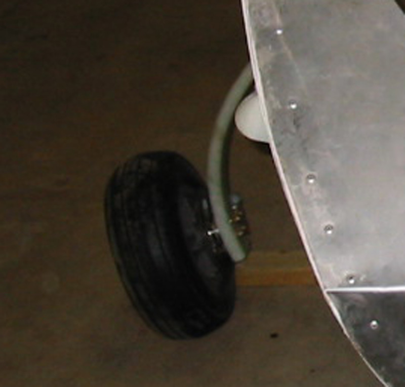

Our tyres are scrubbing excessively on the outside however I think that has more to do with the aircrafts rated MTOW and the torsion that is set into the struts to handle that. Most work is done well under weight hence the wear however I will stand corrected if someone wants to set me straight.
Roger

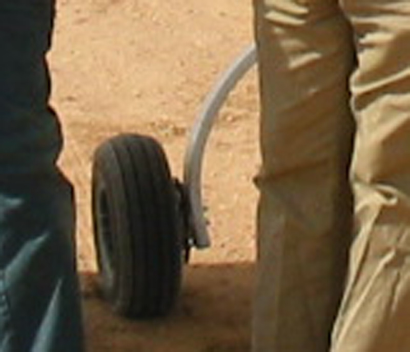

Are the wheels vertical or pointing in at the bottom? and have you checked the tow in? Has it a wedge between the wheel stub and under cart?
In pic one this is before the wedge Pic 2 is after sorry I didn't take a pic when we did the job.
Hi Geoff,
The Jabiru is interstate atm (SA) so I cant check but in relation to your second post the first picture is definitely how our looks.
I wonder why it would be sent out of the factory like this?? Once it gets back I will check it all out and maybe have a talk to you about making it right:crying:

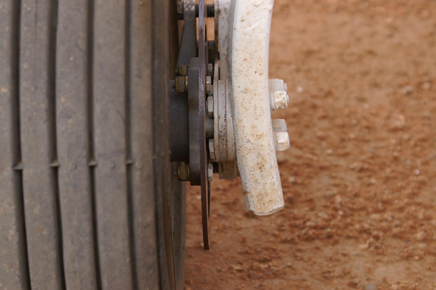

Roger/Geoff The wedge we made is only one part but I can't see why the 2 piece one wouldn't work, Cliff Banks (you said you know him Roger) was the one who put as onto this. so maybe you could get more information from him. One thing we did have to bend 2 bolts slightly to fit. The J160 has 380+ up now mostly on bitumen for one set of tyres.
Do the wedges allow to make the wheel more vertical
Our tyres wear excessively on the inside and even with a fair amount of weight on the aircraft it is difficult to see them take a vertical position
the tyres get about 250 hours before they are worn to a stage where they look to need changing
The last set looked quite bald on examination after replacement but the rubber thichness was still there but they looked ready to pick up any burrs that came along
It was set up at the factory but it still does not look quite right
