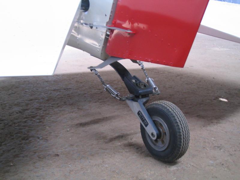

Skyhog Posted April 29, 2009 Posted April 29, 2009 What is the steering link to the tailwheel?There are a few different tailwheel steering mechanisms as we all know,ranging from bungees/springs to castoring/partially castoring.To fly a Thruster it is generally taught to get the tail up ASAP on takeoff as you would be aware Yenn.On some other aircraft such as the Citabria (and maybe the D18) it is recommended not to rush the transition to get the tailwheel off the ground.It sounds a bit like it was hard to control in the 3 point attitude with the tailwheel on the ground,suggesting that the tailwheel may not be aligned with the rudder.Think about if you were happily rolling with the tailwheel on the ground as your steering control and it was 10 degrees different angle to the rudder,then suddenly you lifted it off the ground,there would have to be a drastic change.If you combine this with the torque and slipstream effects as well,it may be quite significant.I could also suggest (as I once did in my Thruster),that you were not paying enough attention with your feet.I didn't groundloop but left the runway.You have probably thought of all these angles but I'm just trying to enlighten other readers of the many variables.

bushcaddy105 Posted April 30, 2009 Posted April 30, 2009 Gooday Yenn Having helped out before with this problem, may I suggest that you check the mechanical advantage between the rudder and the tailwheel. The principle is that for any given amount of rudder pedal movement, the tailwheel should move through a larger deflection angle from straight ahead than the rudder, assuming that there is little, if any, free play in the tailwheel linkage. This ensures that there is more direction control on the ground by the tailwheel than by the rudder as the rollout commences. In the air, this uneven deflection is of no significance. In practice, where the tailwheel is operated by spring links back from the rudder, it requires the lever length (measured from the aircraft centreline) to be longer on the rudder than on the tailwheel assembly. I'll attempt to post a photo to illustrate the above. Hope this helps

facthunter Posted April 21, 2011 Posted April 21, 2011 What hasn't been mentioned is the tailwheel itself. The centre of the wheel is behind the pivot point so it castors. With the wheel on the ground there is a tendency for the pivot to jamb on most setups, due to the offset load. Check that it is free and well lubricated. The spring can deflect too far also if it is not set right, and affect the way the wheel turns. It should be horizontal when the weight of the A/C is on it. Your candidness is most refreshing Yenn. There must be something not right, if a person with your tailwheel experience has a problem with it. Nev
rotor Posted April 21, 2011 Posted April 21, 2011 Nev, The plane has a Matco 6" tailwheel assembly set up as it should be - no jamming here. Before Yenn went out I did stipulate not to try doing fast ground runs and to keep the stick back and the tail wheel grounded. This was what I had been told by people that knew Jodels and their apparent bad ground handling characteristics. I put the whole episode down to bad preparation before the test run. The consequent test flight was fine as far as ground handling went on take off and landing. I did ask the pilot about the ground handling to which he stated that the ground handling was fine. Geoff
