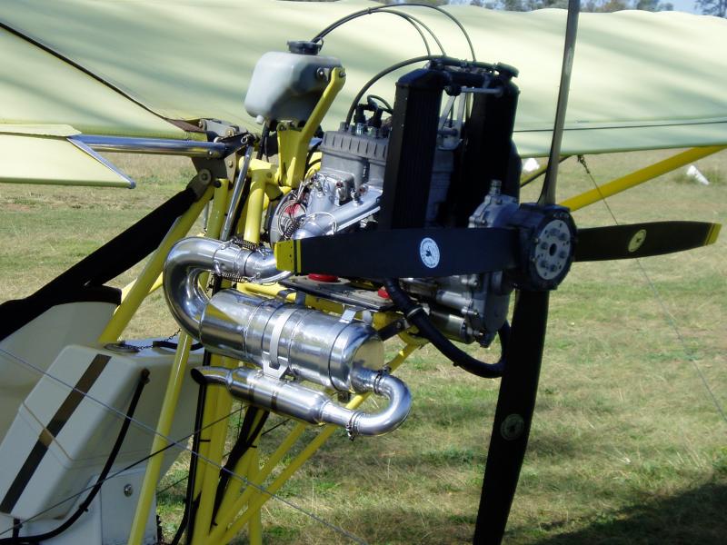

I used it on my J230, on a standard J exhaust, when I built it about 2 years ago, but not on the headers.
Was done to try to reduce temps in the engine bay, and while I don't have definitive comparisons, I am happy with the result as my engine temps are all low.
I was concerned that ceramic coating of the muffler exhaust, around which the Carb heat baffle and cabin heat muff are attached, may have reduced the carb heat capability, but that is fine.
You can see it in the thread J230 @ YSWG and the cost was pretty good, I thought. (It was a couple of years ago, but from memory I posted some photos of the finished job and the cost, so maybe search that Thread for "Ceramic Coating" or similar)
Hope this is of interest. Regards Geoff

I used it on my drifter a few years ago when I first got it. Mainly for corrosion protection. The exhaust was already heavily corroded. I sold that plane but that same exhaust is still going strong today.
