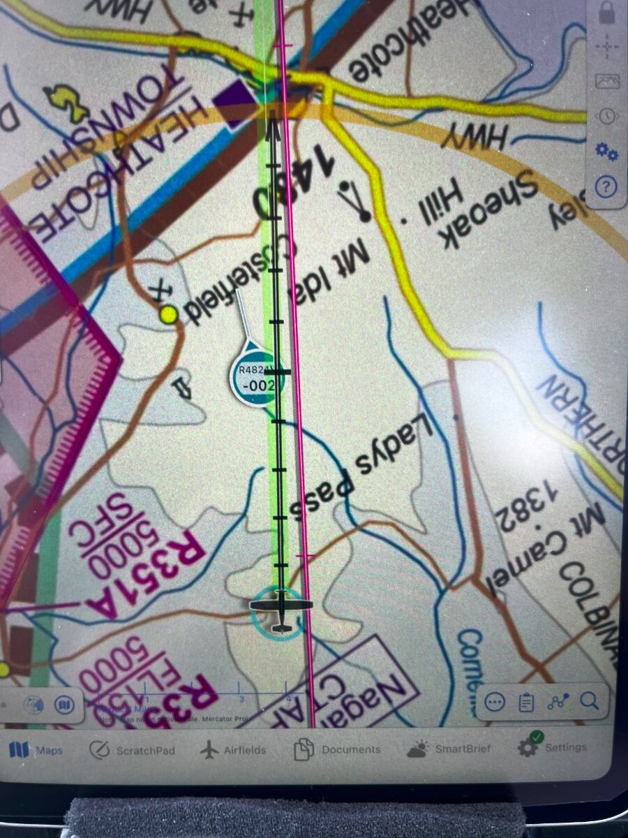

JabiruWeekendWarrior Posted August 27 Posted August 27 Hi Folks, I use OzRunways on a iPad mini with SIM card and earlier this month and today I have flown travelling South West to overfly Heathcote and then more South West. I mainly navigate by line drawn on a VTC and use OzRunways to verify position to hold off wind drift as my card type compass wheel vibrates left and right a bit.. Both times as I get near Puckapunyal army base(VIC) the GPS speed on the Ozrunways goes blank for a few seconds then my plane icon stops but my bubble continues and 5 NM ahead in this picture. I realise something is wrong when I see the base closer than expected and see I have drifter left of track closer to the base than expected and spurs me to recheck again with the iPad. I restart Oz runways and it seems to fix the issue or by the time i have restarted im past and I have attached screen shot showing what I mean. Has anyone else experienced this? 1 2

T510 Posted August 27 Posted August 27 I do a bit of work out at Pucka and often get GPS spoofing alerts. The School of Artillery has a very active UAV program running out there so they could be playing with all sorts of interesting tech 1 3
