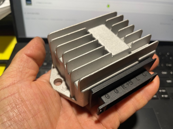

BurnieM Posted June 10 Posted June 10 20 minutes ago, Blueadventures said: I think the heat within the engine bay doesn't help; I put mine on cabin side of the firewall. Motorcycle reg/recs are usually mounted under the seat and inside the side covers directly behind the engine, not too dissimilar to the Rotax engine bay environment. While motorcycles do not sit continuously at 5000 rpm they do regularly go to 9000 rpm. Many motorcycle forums for the last 15-20 years have been recommending replacement with a Mosfet reg/rec. 2 1 1

skippydiesel Posted June 10 Author Posted June 10 12 hours ago, Blueadventures said: I think the heat within the engine bay dosen't help; I put mine on cabin side of the firewall. Like you I put my Ducati VR on the cabin side of the firewall - it lasted about 150hr. I even had a cold air blast tube to help keep the heat down. There have been some very interesting observations on the Rotax Owners Forum - Heat does not seem to be the whole story - Vibration is credited, by many, as the real "killer". Some pretty negative commentary on the quality of the soldered connections = failure due to vibration. I haven't tried this - Apparently you can dig out the putty like filler and do a simple continuity/resistance checks on the connections you uncover. Resolder the faulty ones and your Ducati VR can be put back into service. 😈 1

BurnieM Posted June 11 Posted June 11 12 minutes ago, onetrack said: If vibration is the problem causing regulator failures, then it's easy enough to acquire small rubber vibration isolation mounts (you can even get them from eBay Aerospace), and to install them between regulator and the aircraft frame. I do this with lead-acid batteries on generating sets where vibration can cause battery plate failure. On motorcycles heat transfer or rather lack of heat transfer away from the reg/rec is considered more of a problem. It is often recommended to mount the reg/rec directly to a metal frame member and put heat transfer paste between them. 1 2
facthunter Posted June 11 Posted June 11 Not many flat sections on a Bike frame. I've seen regulators with an AL finned cast Base in front of the engine where it is relatively cool.. The best Mounts for regulators are Made of rubber. When you have an alternator you have to Turn it into DC(Rectify) as well as regulate the current. Nev 1

skippydiesel Posted June 11 Author Posted June 11 6 hours ago, onetrack said: If vibration is the problem causing regulator failures, then it's easy enough to acquire small rubber vibration isolation mounts (you can even get them from eBay Aerospace), and to install them between regulator and the aircraft frame. I do this with lead-acid batteries on generating sets where vibration can cause battery plate failure. Its not that vibration is THE problem, its poor quality soldering - according to Rotax Owner Forum member, who give detailed instructions on how to open, investigate & repair the Ducati VR.😈 1 1

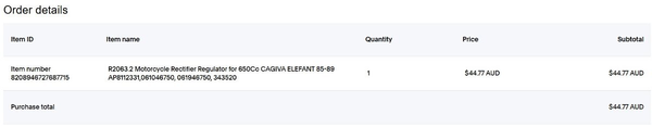

Moneybox Posted June 11 Posted June 11 17 minutes ago, skippydiesel said: Its not that vibration is THE problem, its poor quality soldering - according to Rotax Owner Forum member, who give detailed instructions on how to open, investigate & repair the Ducati VR.😈 I realise some might be concerned about a fire risk of using the Chinese copy but any electrical device can fail in the same way. At $45 a pop repair of the old one would seem like a waste of time. I'm not flying much at the moment so I can't prove its worth but for the ease of fitting I feel it's well worth a shot. We're right into gold prospecting season now so the plane is securely tied down for an extended period. 1 1
