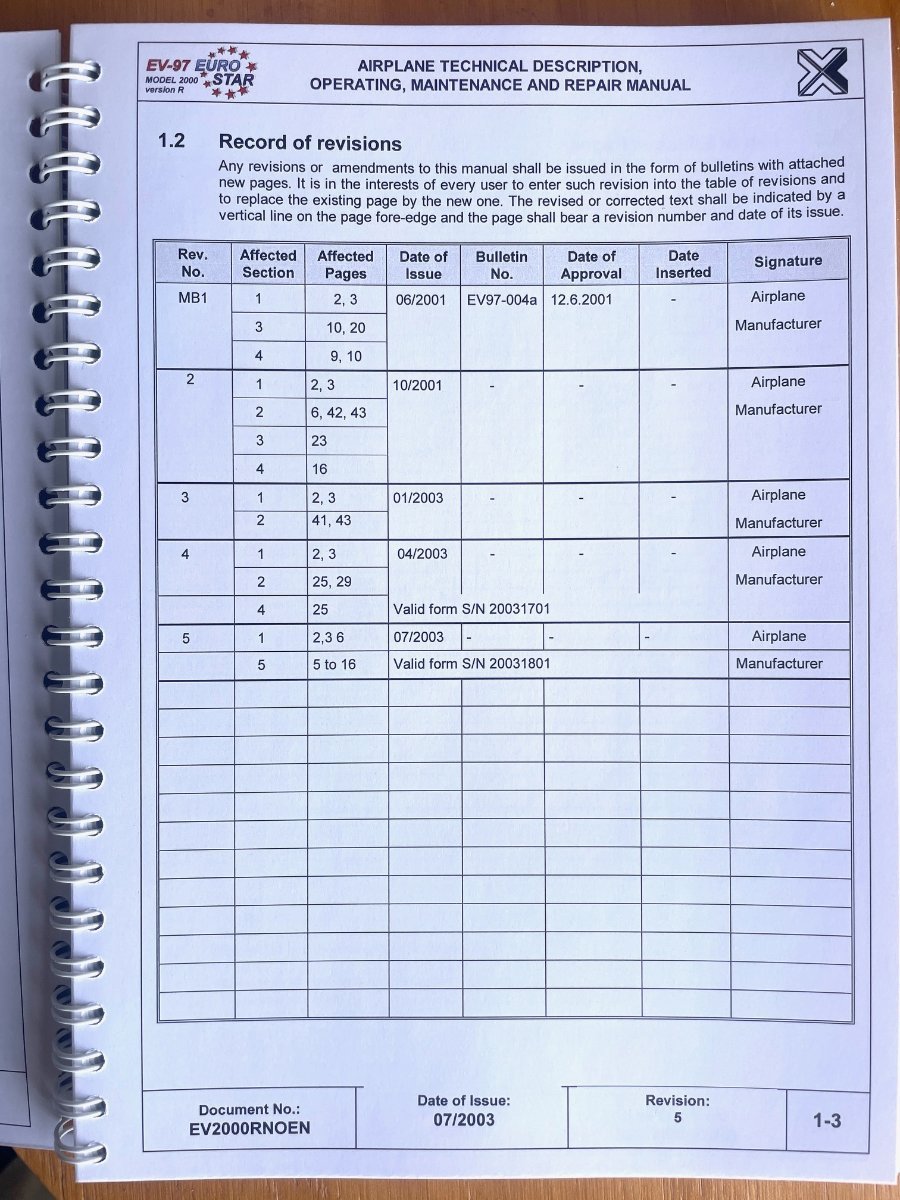

BurnieM Posted February 27 Posted February 27 15 hours ago, Moneybox said: I picked up my books from the post this morning. Evektor Book.mp4 2.37 MB · 0 downloads They print A4 paper so an extra book only costs a few dollars extra. You known thats a EuroStar (EV97) POH right ? Dont you have an early model SportStar (EVSS)
Moneybox Posted February 27 Author Posted February 27 (edited) 2 hours ago, BurnieM said: You known thats a EuroStar (EV97) POH right ? Dont you have an early model SportStar (EVSS) You'd think so Burnie but look at the dates. The 97 must have another meaning because the Sportstar was not produced at that time. Mine serial number/date is 2004 0305 Edited February 27 by Moneybox
BurnieM Posted February 27 Posted February 27 I understood that the Sportstar was approved as an LSA in the US in 2005 but probably built earlier. I believe the Eurostar was a lighter weight and only sold in Europe. Evektor re-used the EV97 ICAO identifier on the Harmony.
BurnieM Posted February 27 Posted February 27 This may be useful; says Sportstar POH, Dec 10 2003, second edition. Looks like it has a single tank. https://www.skyviewultralights.ca/student-resources https://www.skyviewultralights.ca/_files/ugd/f9edee_eee78221340d4f549dc388370bb89005.pdf?index=true 1
BurnieM Posted February 27 Posted February 27 Actually says "Flight Manual for SportStar Ultraight Airplane" but has everything I would expect in a POH. 1
Moneybox Posted February 28 Author Posted February 28 That looks good Burnie but my book has been accepted because the data matches the plane so I'm happy enough with that for now. All approved by the workshop and LAME and submitted. RAAus said to expect a favourable response before the end of next week. 1
BurnieM Posted February 28 Posted February 28 If you put Evektor in as a manufacturer here you get the official ICAO type codes for their different models - https://www.icao.int/publications/DOC8643/Pages/Search.aspx You can see Evektor re-used the EV97 code on 2 different models but neither is the Sportstar The Sportstar is EVSS. While your manual may have been accepted by RAAus as valid it could cause legal problems later on. 1

Moneybox Posted February 28 Author Posted February 28 28 minutes ago, Blueadventures said: All good; my comments meant to be a help, not criticise you or load you up with stuff. Just ideas for your consideration. I know how busy you are and you have done well. Cheers. Thank you. I've just been back to the plane to cover the pitot. I forgot about it. I just got the ASI put back in before daylight faded. When connected to the calibrated test rig had a consistent difference of about 8 kt between 30 and 145 kts. It was a very simple fix by rotating the needle on its spindle. Now it's within one to two kts so I'm much happier with that. I did the carburettor balance with the mercury filled slack tube manometer. Peter (my LAME) brought his prop balancer and electronic carburettor balancer but didn't touch either. He said there was no way he was going to improve the way it was performing. I've been flicking through Burnie's document and as far as I can tell it's correct. I think the figures are all identical to my new book but it's a shortened version with the title Sportstar instead of Eurostar. Peter verified the weights, measures and performance figures so I'm happy to stick with the ($160 to print) book I have. I'll be sure to make corrections if any errors are found. 2
