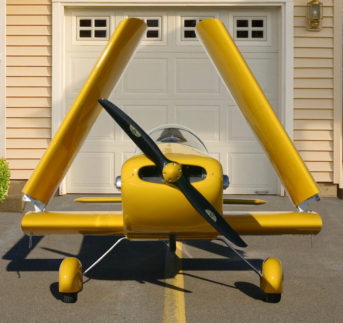

One builder has upward hinged folding wings .
Dave King 19-1945 has a Rotax air-cooled motor in his .
spacesailor
9 hours ago, Geoff_H said:
I like it.  Any details on the way it was converted?
It’s not a converter Corby but rather a stock standard Sonex Onex
