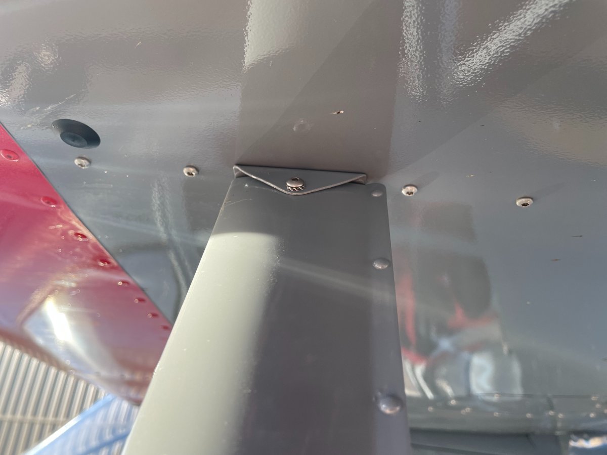

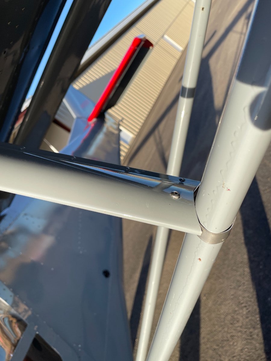

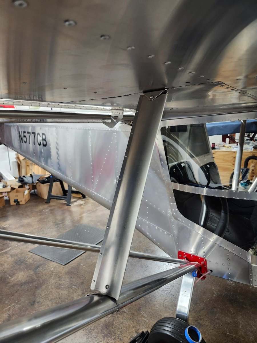

Bodie Posted November 20, 2023 Posted November 20, 2023 (edited) Hey Bryan. I was able to get some pics for you. I hope they help. Please ignore the paint runs in the third pic. Don't paint outdoors in a cold November in Montana! -steve Edited November 20, 2023 by Bodie embarrassment? 1
BC0979 Posted November 21, 2023 Author Posted November 21, 2023 IBob and Bodie Thank you! This is exactly the help I needed. 1

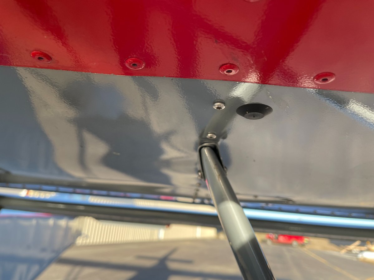

BC0979 Posted January 29, 2024 Author Posted January 29, 2024 These jury struts are a pain in the you know what, LOL Right side took over 5 hrs but the left side was done in 1.5 hrs. Not my best work but they are installed   2
