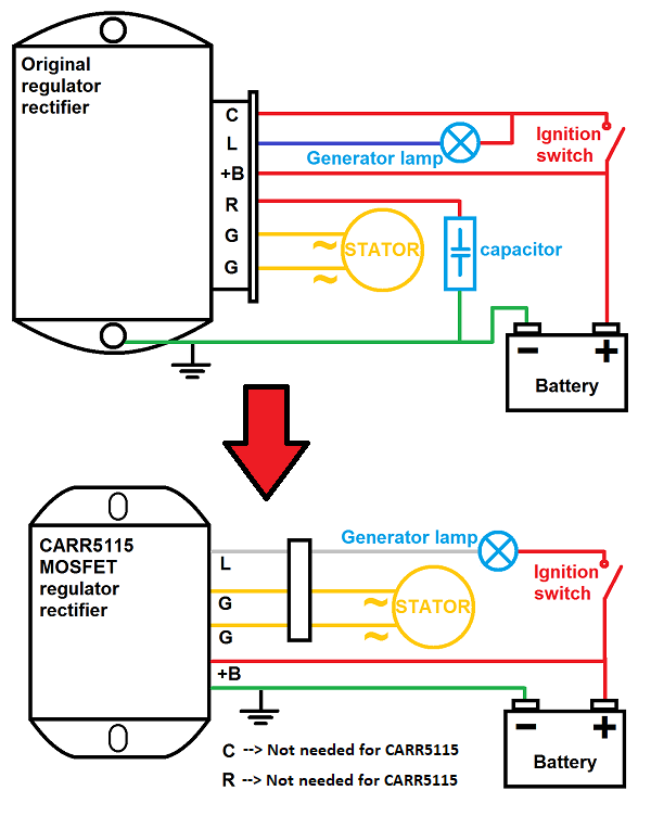

Red Posted September 8, 2024 Posted September 8, 2024 On 23/03/2023 at 8:47 AM, danny_galaga said: Latest item is the regulator/rectifier. I got a Carmo. Less wires and runs cooler. Made in the Netherlands. HUP HOLLAND! HUP! 🙂 Danny I just got a carmo reg/rec.....did you ground the case?, the accompanying drawing shows no ground connection to case which tbh would make things difficult mounting wise, I'll give carmo a call on monday but saw you mention them and thought worth an ask 1
danny_galaga Posted September 8, 2024 Author Posted September 8, 2024 4 hours ago, Red said: Danny I just got a carmo reg/rec.....did you ground the case?, the accompanying drawing shows no ground connection to case which tbh would make things difficult mounting wise, I'll give carmo a call on monday but saw you mention them and thought worth an ask You don't need to ground the case per se as there is a negative lead. I hadn't given that much thought as mine is in a new build so I wired it accordingly. Good question! 1
skippydiesel Posted September 8, 2024 Posted September 8, 2024 I ground my rectifier/regulator case by; Fixing it to the metal airframe Running a dedicated earth/ground wire, from one of the fixing screws, to a negative bus I strongly recomend the installation/use of a dedicated negative/earth return circuit for all 12 volt systems. 1 1 1
danny_galaga Posted September 8, 2024 Author Posted September 8, 2024 27 minutes ago, skippydiesel said: I ground my rectifier/regulator case by; Fixing it to the metal airframe Running a dedicated earth/ground wire, from one of the fixing screws, to a negative bus I strongly recomend the installation/use of a dedicated negative/earth return circuit for all 12 volt systems. Agree. In this case we are talking about the CARR5115 regulator.
skippydiesel Posted September 9, 2024 Posted September 9, 2024 Nice clear schematics Danny - Although not shown, would still run a dedicated negative/earth return circuit connecting to the device body. Although chassi/airframe returns are common, I don't like their potential, over time, for a little bit of oxidisation /paint/dirt/movement to increase the return resistance, in some cases, to the point of nil continuity. The cost & weight of dedicated return circuit (usually in parallel with the airframe) is negligible.
danny_galaga Posted September 9, 2024 Author Posted September 9, 2024 (edited) 55 minutes ago, skippydiesel said: Nice clear schematics Danny - Although not shown, would still run a dedicated negative/earth return circuit connecting to the device body. Although chassi/airframe returns are common, I don't like their potential, over time, for a little bit of oxidisation /paint/dirt/movement to increase the return resistance, in some cases, to the point of nil continuity. The cost & weight of dedicated return circuit (usually in parallel with the airframe) is negligible. You're preaching to the converted. Earth return on everything on my build. My regulator is hooked up directly to the positive and negative of the battery (well from memory to the bus bar) and the heat sink itself doesn't require an earth from memory as you can see from the differences in the two regulator diagrams. Edited September 9, 2024 by danny_galaga
Blueadventures Posted September 9, 2024 Posted September 9, 2024 (edited) 11 minutes ago, danny_galaga said: You're preaching to the converted. Earth return on everything on my build. My regulator is hooked up directly to the positive and negative of the battery (well from memory to the bus bar) and the heat sink itself doesn't require an earth from memory as you can see from the differences in the two regulator diagrams. And the negative green connects to airframe. As well as battery negative? Agree heat sink / mount does not need to be grounded. Edited September 9, 2024 by Blueadventures
danny_galaga Posted September 9, 2024 Author Posted September 9, 2024 (edited) 1 hour ago, Blueadventures said: And the negative green connects to airframe. As well as battery negative? Agree heat sink / mount does not need to be grounded. The only "earth" on my plane is the negative battery cable going to a bolt on the starter motor rear housing. Everything else is negative wired. The airframe almost certainly has negative potential because something will ground the engine to it somewhere along the way (for instance the throttle cable. Or maybe the Facet fuel pump) but it's not part of the "deliberate" electrical system. Edited September 9, 2024 by danny_galaga
Blueadventures Posted September 9, 2024 Posted September 9, 2024 41 minutes ago, danny_galaga said: The only "earth" on my plane is the negative battery cable going to a bolt on the starter motor rear housing. Everything else is negative wired. The airframe almost certainly has negative potential because something will ground the engine to it somewhere along the way (for instance the throttle cable. Or maybe the Facet fuel pump) but it's not part of the "deliberate" electrical system. 41 minutes ago, danny_galaga said: The only "earth" on my plane is the negative battery cable going to a bolt on the starter motor rear housing. Everything else is negative wired. The airframe almost certainly has negative potential because something will ground the engine to it somewhere along the way (for instance the throttle cable. Or maybe the Facet fuel pump) but it's not part of the "deliberate" electrical system. Just asking if the green wire from the RecReg going to the battery negative; also has a connection to the airframe? Like in the schematic. On my build I has three negative ground posts that all grounds connect to so I'm not relying on the airframe connection to the battery negative for grounding circuit. Cheers. 1
skippydiesel Posted September 9, 2024 Posted September 9, 2024 41 minutes ago, danny_galaga said: The only "earth" on my plane is the negative battery cable going to a bolt on the starter motor rear housing. Everything else is negative wired. The airframe almost certainly has negative potential because something will ground the engine to it somewhere along the way (for instance the throttle cable. Or maybe the Facet fuel pump) but it's not part of the "deliberate" electrical system. Earth/Ground/Negative - pretty much all the same in 12V circuit. Terminology varies with country/upbringing. Probably should have taken "holy orders" - you have sort of made my point - connect everything electrical (all bodies/housings/mounting brackets) to a negative return circuit. You will never regret it and may even come to "Thank the Lord" you went down this track (I even do my cars like this )😈
danny_galaga Posted September 9, 2024 Author Posted September 9, 2024 Yeah, we are saying the same thing in different ways. Electrically, saying "earth" on DC voltage electrics in cars, trucks etc implies a common "ground" connection, nowadays always negative via a metal chassis, body etc. as you know, that's what is happening in your car. Just saying "negative" doesn't automatically tell you how it's created. That's why I was trying to be really clear. Some cars up until the 1950's had positive ground! Pommy of course 😄 So with my auto electrical background, knowing how problematic earth return/ground/common is on things like trailers and boats, I fully understand and embrace "earth return" wiring in an aircraft. That is, wire carries the current for both positive and negative. No device on my aircraft is powered via current transmitted through the metal of the airframe. 1
danny_galaga Posted September 9, 2024 Author Posted September 9, 2024 2 hours ago, Blueadventures said: Just asking if the green wire from the RecReg going to the battery negative; also has a connection to the airframe? Like in the schematic. On my build I has three negative ground posts that all grounds connect to so I'm not relying on the airframe connection to the battery negative for grounding circuit. Cheers. No. I'm not even sure why they put that earth symbol there, other than to say if you've wired your aircraft with negative earth (that is, instead of having a negative wire going to devices, the battery negative connects to the metal airframe and your device gets its negative from the airframe, like a car does). In any case it's probably best to use wire for the negative of your regulator, not the airframe.

Red Posted September 9, 2024 Posted September 9, 2024 9 hours ago, skippydiesel said: I ground my rectifier/regulator case by; Fixing it to the metal airframe Running a dedicated earth/ground wire, from one of the fixing screws, to a negative bus I strongly recomend the installation/use of a dedicated negative/earth return circuit for all 12 volt systems. Carmo reg has a negative lead
Red Posted September 9, 2024 Posted September 9, 2024 3 hours ago, danny_galaga said: Yeah, we are saying the same thing in different ways. Electrically, saying "earth" on DC voltage electrics in cars, trucks etc implies a common "ground" connection, nowadays always negative via a metal chassis, body etc. as you know, that's what is happening in your car. Just saying "negative" doesn't automatically tell you how it's created. That's why I was trying to be really clear. Some cars up until the 1950's had positive ground! Pommy of course 😄 So with my auto electrical background, knowing how problematic earth return/ground/common is on things like trailers and boats, I fully understand and embrace "earth return" wiring in an aircraft. That is, wire carries the current for both positive and negative. No device on my aircraft is powered via current transmitted through the metal of the airframe. I agree that is best practice and already provided with the Carmo, did you end up with the case grounded anyway just because its easier to mount to something metal thats probably grounded itself and adds some heatsinking?
danny_galaga Posted September 9, 2024 Author Posted September 9, 2024 1 hour ago, Red said: I agree that is best practice and already provided with the Carmo, did you end up with the case grounded anyway just because its easier to mount to something metal thats probably grounded itself and adds some heatsinking? I haven't looked at it closely but I seem to recall the mounts are stand off, which lets air circulate behind. My firewall is fibreglass, with aluminium covered fibreglass heat shielding, so maybe it's grounded on that but (again from memory) the regulator is potted in a generic heat sink So I don't know if there is even an electrical connection, in other words I have a feeling it's above ground.
