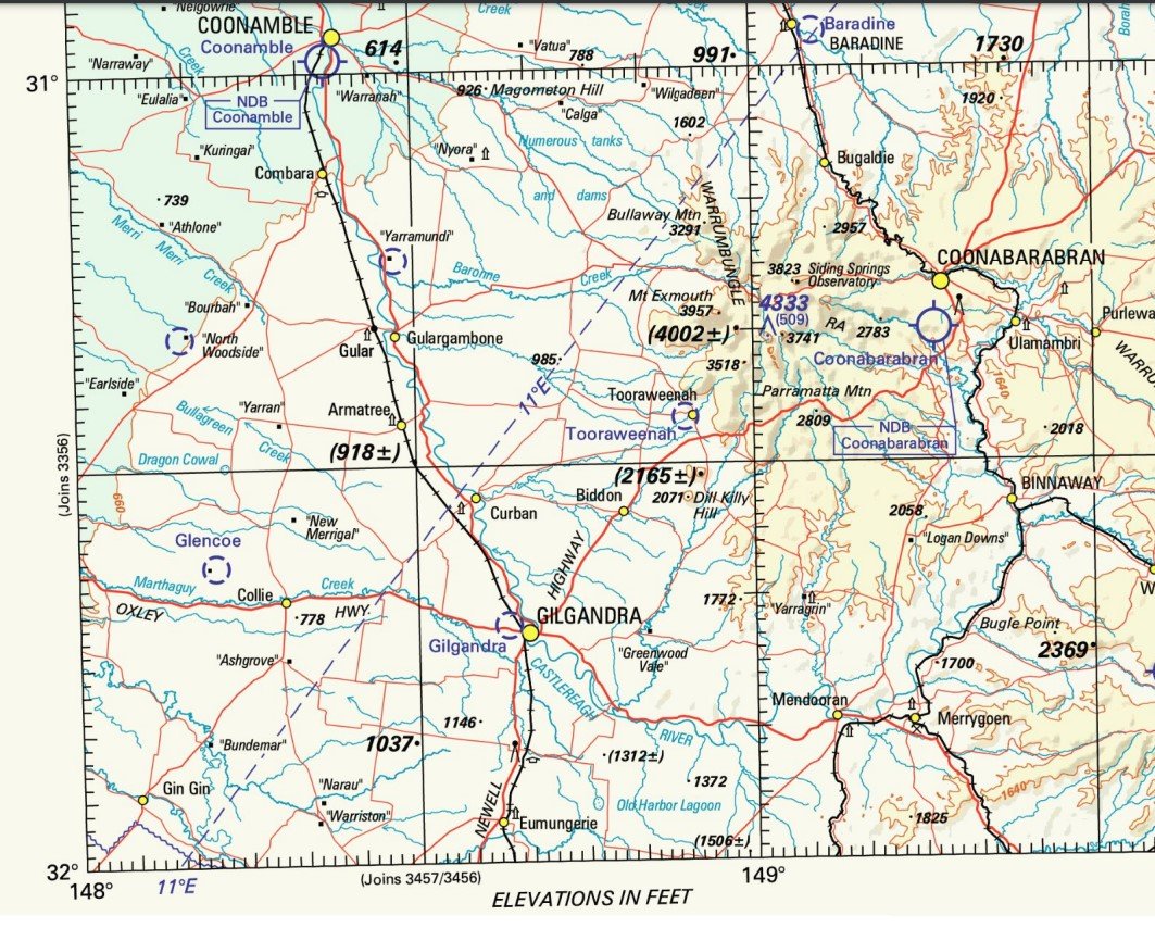

Here are the areas covered by VTCs in Australia image.jpeg.07a9656b3d10288c4d5892062243593b.jpeg and here are the VNCs image.jpeg.a006456a77d9dfabc88926debe22079f.jpegLots of blank spaces for you to fill with your personally specified waypoints.

Here are the areas covered by VTCs in Australia  and here are the VNCs Lots of blank spaces for you to fill with your personally specified waypoints.

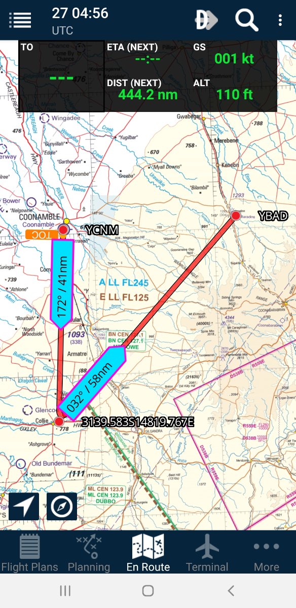

Case in point - I don't even know where this is on the map in Australia.
Let's say I want to fly COONABLE -> COLLIE -> BARADINE
How do I know what the waypoint are to put into my flight plan without it being specified on the map. COONABLE/BARADINE presumably have airport ICAO identifiers that make it easy. But COLLIE may / may not have a VFR way point specified
See those numbers with the little circle beside them? They are degrees of latitude and longitude, in a grid system. You count down from the top to the location, eg Collie, and that will give you what are called "Northings". Then you do the same thing from left to right. That will give you what is called an "Easting"  You enter those grid coordinated in your flight planning gizmo, but for flights in Australia the Northing is entered as a negative number because we are below the Equator (0 degrees). Eastings in Australia are alway a positive number.
See if you can find these locations on the map I posted.
You can check yours answers on Google Maps if you centre on this location: 111 Tooraweenah Aerodrome Rd, Tooraweenah.
