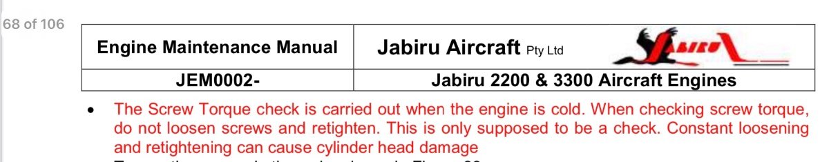

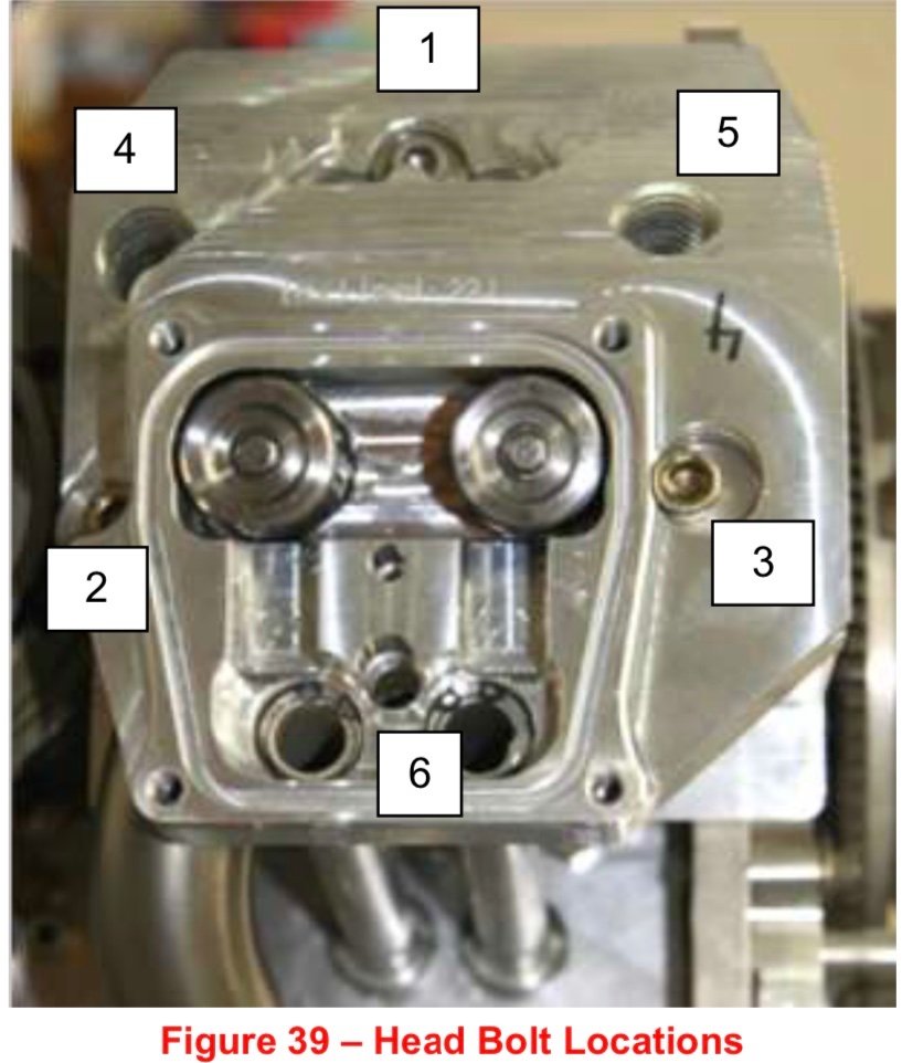

Old Koreelah Posted April 13, 2023 Posted April 13, 2023 Glen I read somewhere recently that Jabiru advise to NOT back off the headbolts before torquing them up. Based on that, I just put the recommended torque on a long Allen key, via a pipe mounted over it and a recently calibrated spring balance pulling at the appropriate distance along that. Which bolts? The six Allen bolts on each head, including the one hidden under the plug in the rocker box. 1
RFguy Posted April 13, 2023 Posted April 13, 2023 (edited) I mean WHICH screws out of the 6 moved ? I cant beleive that is Jabiru's advice as it is bollocks in IMO if that is so. Problem is dynamic version static friction influencing torque. Hence the reason to back them off to they are moving when you are measuring torque. Otherwise resultant tension could be out by perhaps 2:1... as you are overcoming static friction, corrosion etc etc lots of errors. Edited April 13, 2023 by RFguy 1

Old Koreelah Posted April 14, 2023 Posted April 14, 2023 8 hours ago, RFguy said: I mean WHICH screws out of the 6 moved ? I cant beleive that is Jabiru's advice as it is bollocks in IMO if that is so. Problem is dynamic version static friction influencing torque. Hence the reason to back them off to they are moving when you are measuring torque. Otherwise resultant tension could be out by perhaps 2:1... as you are overcoming static friction, corrosion etc etc lots of errors. Thanks for your feedback Glen. Which head screws moved? On Head 1, Number 6 moved c.30 degrees. On Head 2, bolt 2 moved 10 degrees, 3 moved 20 degrees and 6 moved 30 degrees. On Head 3 no bolts moved. On Head 4, 2 moved 20, 3 moved 10 and 6 moved 35 degrees. Thus, mostly the bottom bolt, not the top three. Perhaps because the bottom of the head gets less cooling air and therefore hotter and more likely to soften? Inside my tappet covers is not as shiny as it was at 100hrs. Since then, CHTs have exceeded 160 a couple of times (but none have ever approached the 180C often quoted as max.)Testing with two other instruments have convinced me the CHT readings are within 10 degrees of true. What you say about backing offhead bolts makes more sense to me than the factory advice; being a 19-reg homebuilt, I have cast a wide net for maintenance ideas. Despite not having always complied with some of the factory’s earlier suggestions, the engine has given years of trouble-free service. 1

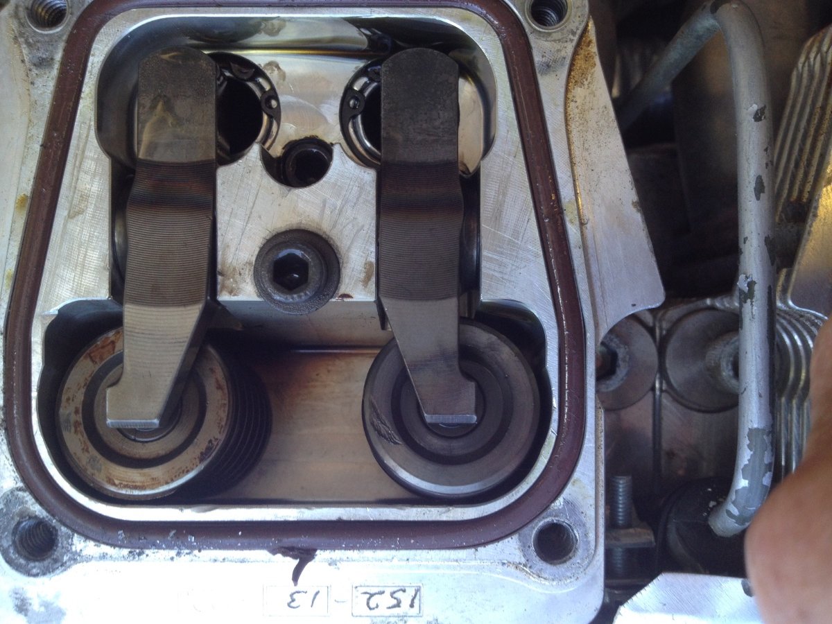

RFguy Posted April 14, 2023 Posted April 14, 2023 (edited) Well the #6 telltale will likely be recession., that's the hottest spot.... Do check that the rockers slide left right at TDC. exactly how much spare clearance you have depends on WHICH lengthof push rod Jabiru gave you. they vary.... most of the original Gen3 were too long and then went down a couple of mm ! (and didnt tell anyone and the manual has errors) eventually, you'll need to remove the heads , milled down say 0.9mm from the non recessed area so you get a nice flat surface again, and then drop in a 0.9mm shim. like below : Edited April 14, 2023 by RFguy 1

Markdun Posted April 15, 2023 Posted April 15, 2023 The trouble with those numbers on torque is that what you are seeing is variation from other variables, which are unrelated to bolt tension which torque is merely a proxy for. I doubt the head cap screws are the same alloy as the cylinders and the variation are probably more to do with varying electrolysis / corrosion of the threads of the cap screws in the cylinder. Most likely the lower head screw has less corrosion and moves easiest. FWIW I think the purpose of head bolt tension checks is to assess whether there is recession, except perhaps a check at 5-10 hours after the head has been replaced. As such I think it is better to do head bolt tension checks far less frequently than specified in the maintenance manual, and to do the torquing properly, ie dynamic by backing off and then re-torquing. And given how easy it is to pop off the head on the Jab to have a squiz, why not do that at 300 hours? 1
