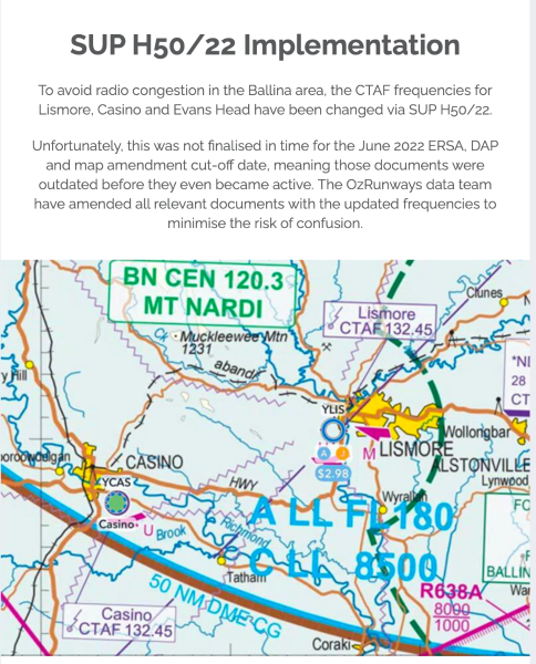

Interesting that OzRunways were able to incorporate the frequency changes in AIP SUP H50/22 (Ballina MBA/SFIS)
on their version of the charts whilst the feds missed the deadline for their own new document releases.
s22-H50.pdf
From OzRWYs email circular:
