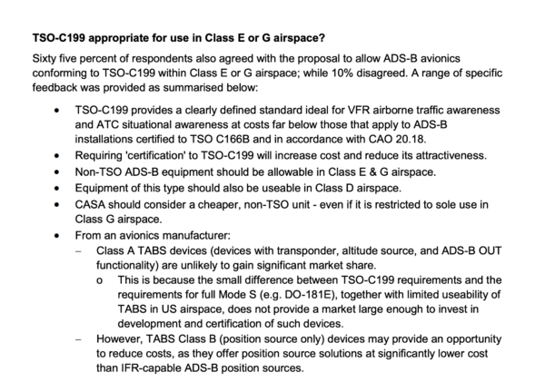

One question that has come up here several times - with no clear answer yet - is whether low cost, non-TSO'd (but approved) ADSB IN-OUT gear like the SkyEcho2 might be deemed acceptable in Class E (current high or future low) or even, Class D.   So I was interested in this part (see below) of the "Summary of Consultation" 09/18  (linked to above.)
It shows that ideas like that have, at least, been discussed and may yet be under consideration. It seems to me that the feds want to get a feel of how the voluntary uptake of affordable ADSB for VFR goes in practice (especially after the government subsidy kicks in).
[THIS TEXT IS A SCREENSHOT IMAGE SO NEEDS CLICKING TO SHOW FULL REZ.]
