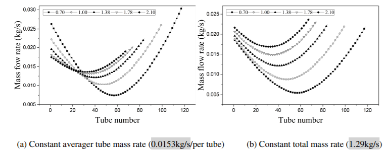

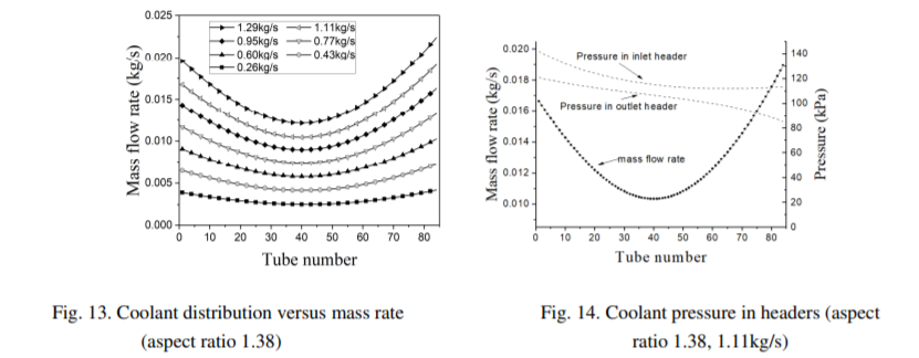

RFguy Posted January 19, 2022 Posted January 19, 2022 (edited) In my case I have generally, lots of space in the horizontal plane, and little in the vertical plan, so cross flow will give me the most useful geometry from a number of cores perspective . From what I read, getting even flow distribution is more difficult the more pipes you have/longer the tanks. in the wide aspect cross flow, the tanks are short in length (height), and the number of pipes is less. I'm sure there is a expert here that can pipe up on this. If the resistance of the flow in each tube is low compared to the input pressure than the system should self balance. IE long tubes in a cross flow will have higher individual pressure drop than short tubes. and thus they'll distribute more evenly. But its not quite so simple- since there is variation in density, volume as the fluid goes from hot to cold ! more reading required. Edited January 19, 2022 by RFguy
RFguy Posted January 19, 2022 Posted January 19, 2022 (edited) I found a good paper to read "Effect of non-uniform airflow on the performance of a parallel-flow heat exchanger considering internal fluid distribution" document source : https://doi.org/10.1016/j.applthermaleng.2020.115685 Now, interesting for this crossflow radiator (aspect = 1.38) square uniform side tanks, no special shapes) as the mass flow rate goes up, so does the variation in distribution of flow. and that the tubes in the middle suffer . A number of different aspect ratios was tested (width/height ratio), and non uniformity of flow distribution increases with reducing aspect ratio- so square is crap. and because of the pressure drops in the tubes becomign greater compared ot the in/out tank presssures as I'd expected (very similar to electricity and laws of current sharing) . and when you take into account the effects of non uniform airflow , then the radiator performance will decrease more quickly (and we are talking 4x difference for aspect = 0.7 to aspect = 1.4 ) This is significant. so use wide aspect ratios. 2:1 or better. Edited January 19, 2022 by RFguy 1
skippydiesel Posted January 20, 2022 Author Posted January 20, 2022 Ah! BUT orientation of the tank/tubes (ref your statement & my Q) should have very little difference on performance. You can pretty much put a Rotax radiator in any position and get the same efficiency SUBJECT TO GOOD AIR FLOW. This holds good for all radiators - I have converted a Ford Falcon cross flow radiator (tank on each side horizontal tubes) to vertical (tank top/bottom tubes vertical - did the same job as when in in its previous orientation. Radiator orientation has more to do with space availably than physics. 1
