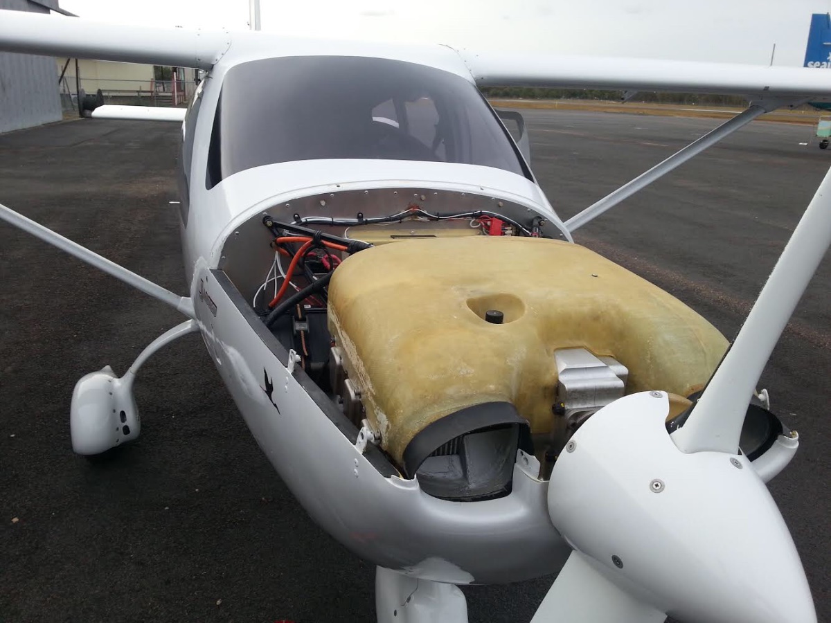

RFguy Posted January 18, 2022 Posted January 18, 2022 (edited) Skippy while we're online workshopping this something I am thinking about right now is whether I get 2 x motorcycle radiators and put them behind the existing cowling inlets, or use 6" to 8" dia ducting and pipe the air where I can put the radiators somewhere simpler. duct like this : https://airtight.com.au/product/hightempflex/ 6" duct, $200/meter . 6" ID would be 182cm2. Two of those would be a little on the marginal side. (362- I need 440) It might be easier in the cowling to run 2 x 5" ducts per side instea dof a six. each 4" duct is 122cm2, so four in total is 490cm2. not bad. or just some SCAT hose 4" is $40 per foot. there are some pre formed NACA ducts you can buy , also for racecars etc... http://www.revolutionracegear.com.au/index.php?PCID=10550 etc Now, you could use a large scoop area and smaller duct (and it operates at higher pressure/velocity so the heat calcs are different). like brake scoops with 3" duct. But then the radiator must work ovber a smaller area or you need to reverse at the radiator end....) Maybe a couple of preformed NACA ducts on the cowling. https://www.chilloutsystems.com/products/4inch-carbon-fiber-naca-duct there should be 3D STL files ont he internet to get them printed in your favourite material at a 3d print agency Indeed, search NACA duct on thingiverse, and there is plenty you can print https://www.thingiverse.com/search?q=NACA+duct&type=things&sort=relevant https://buildingspeed.org/2012/12/21/whats-a-naca-duct/#:~:text=The length and shape of,a lot of extra drag. https://www.motortrend.com/how-to/naca-duct/ but a NACA duct is not goign to convert 400cm2 of duct opening area to 400cm2 of equivilent open facing inlet duct, they dont work that way. AND the long duct work will have pressure drop and that will drive everything...... BTW 100mm duct 1m long , straight , 0.5mm roughness, will be about an inch of water drop at 80 kts. going up to 125mm duct, a quarter of an inch of water for same airflow. larger openings = higher airflows so higher pressure drops. BUT this tells me 4" duct for 4" opening is OK, just . 5" duct for 4" opening is great. 5" duct for 5" opening is OK. (80 kts). going from 0.5 to 1mm roughness doesnt hurt much. Edited January 18, 2022 by RFguy

skippydiesel Posted January 19, 2022 Author Posted January 19, 2022 18 minutes ago, RFguy said: Skippy while we're online workshopping this something I am thinking about right now is whether I get 2 x motorcycle radiators and put them behind the existing cowling inlets, Europa Aircraft use this system - looks heavy & complicated but must work. Probably lends itself to a smaller frontal area/look or use 6" to 8" dia ducting and pipe the air where I can put the radiators somewhere simpler. duct like this : Some of the Sonex /Rotax912 installations I have been looking at go with a radiator on one side of engine bay using a composite duct from front and a side exit exhaust/ air vent https://airtight.com.au/product/hightempflex/ 6" duct, $200/meter . 6" ID would be 182cm2. Two of those would be a little on the marginal side. (362- I need 440) It might be easier in the cowling to run 2 x 5" ducts per side instea dof a six. each 4" duct is 122cm2, so four in total is 490cm2. not bad. or just some SCAT hose 4" is $40 per foot. there are some pre formed NACA ducts you can buy , also for racecars etc... http://www.revolutionracegear.com.au/index.php?PCID=10550 etc Now, you could use a large scoop area and smaller duct (and it operates at higher pressure/velocity so the heat calcs are different). like brake scoops with 3" duct. But then the radiator must work ovber a smaller area or you need to reverse at the radiator end....) Maybe a couple of preformed NACA ducts on the cowling. https://www.chilloutsystems.com/products/4inch-carbon-fiber-naca-duct there should be 3D STL files ont he internet to get them printed in your favourite material at a 3d print agency Indeed, search NACA duct on thingiverse, and there is plenty you can print https://www.thingiverse.com/search?q=NACA+duct&type=things&sort=relevant https://buildingspeed.org/2012/12/21/whats-a-naca-duct/#:~:text=The length and shape of,a lot of extra drag. https://www.motortrend.com/how-to/naca-duct/ but a NACA duct is not goign to convert 400cm2 of duct opening area to 400cm2 of equivilent open facing inlet duct, they dont work that way. AND the long duct work will have pressure drop and that will drive everything...... Not all, so described, NACA ducts are NACA especially those that come from automotive sources - true NACA have specific dimensional ratios. Be careful - may look "the goods" but not deliver. I thought you were a died in he wool front of cowling radiator man - what has caused this change of heart?

RFguy Posted January 19, 2022 Posted January 19, 2022 no change of heart from me Skippy, just thought you might like some more ideas. radiators are still best to go and face the wind, given that I already have cowling openings .... 1
skippydiesel Posted January 19, 2022 Author Posted January 19, 2022 1 hour ago, RFguy said: no change of heart from me Skippy, just thought you might like some more ideas. radiators are still best to go and face the wind, given that I already have cowling openings .... I agree - just like you I have been presented with an existing layout that I would like to try befor making any significant changes. If mine works GREAT! If not will be rejigging the whole shebang (probably radiator at front of cowl)
RFguy Posted January 19, 2022 Posted January 19, 2022 (edited) I've found a mfr that makes some small industrial heat exchanger high performance radiators, all copper, lots of specs. affordable. https://www.alphacool.com/alphacool-nexxxos-v.2-radiatoren https://www.alphacool.com/download/ENG_1015512_NexXxoS_V2_XT45_240.pdf https://www.alphacool.com/shop/radiators/radiators/240-mm/20477/alphacool-nexxxos-xt45-full-copper-x-flow-240mm-radiator They'll fit nicely in the airflow in the cowling inlets with a minor enlargement. All shapes and sizes off the shelf, about $100 per unit. But they weigh a kilo each. alot of copper. Edited January 19, 2022 by RFguy
