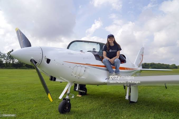

The Shark.aero as flown by Zara Rutherford is one of the fast ones. It has quite large cowl intakes and a pilot controlled "scoop" on the main naca inlet duct. In google images of this aircraft the scoop is open a fair bit.
Putting pre heated air through your radiator will surely increase the total cooling air flow required,  that has to be more drag and less speed.

Where that shark.aero has the inlet scoop, that is a fair way from the prop, a bit cleaner airflow -  and might give you some food for thought ---- that is in I would call the transition region , compared to the cooling openings adjacent to the spinner where the airflow is highly disturbed by the prop.
SKip, I had thought about having my radiator there approx where the cowling lip is and be able to adjust the amount of tilt of the radiator into the wind. IE from full blow to tilted 'up'  into the cowling gap (relying on the cowling thru air)
It's not going to change drag much because I am no longer using the cowling suction lip  . But it's likely I will put it just below the prop.

The Shark Aero would seem to have a plethora of inlets & outlets. Are they all functional?  Not sure its obvious what inlet/outlet serves what purpose. Nice looking aircraft somewhat spoilt by too many fish like accents.
