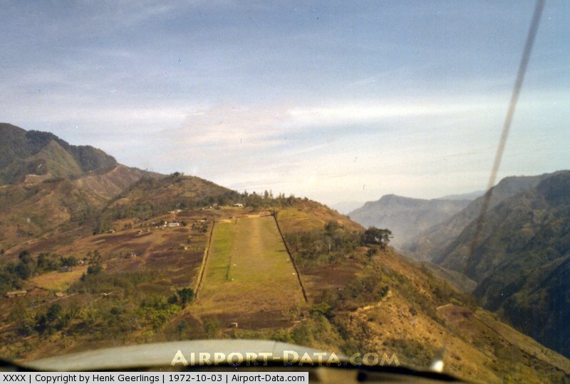

poteroo Posted November 5, 2021 Posted November 5, 2021 Luckily, I've never had to do a dead-stick onto a steep slope : my experience has always been with all engines running, although sometimes with near gross load,(MTOW). I reckon the pilot concerned did a pretty good job. Any slope over 5% is going to require a fair change in technique. We were taught to make sure we turned final at a set altitude, and to fly the approach with sufficient flap to allow us to have some reserve power for the inevitable sink on very short final, as well as to carry the aircraft forward above Vso as eyes were raised to the top end of the strip. I usually added power in the flare so as to not hit the slope too hard if I misjudged things. Some pilots added 5-10 kts to their Vref but this was more useful on the really steep ones, eg, over 14-15%. The early C206 had inadequate elevator command, and several were bingled on steep strips. Later models were improved. The C185s that I was primarily using were great for the shorter strips, (60 KIAS on final), but on the steeper slopes it tok quite a change in attitude to get them to 3 point. We usually 3 pointed in case of soft surface. I can't remember ever operating on anything over 17%, (commercial PNG ops had a few more restrictions than the Missionaries, MAF and private operators). Some of their strips we used to fly past and marvel at how they ever managed. One Missionary pilot of legend, said it was doubly hard for him, as a priest, because he flew one handed while rubbing his crucifix with the other!! When I began to route & strip endorse, it required a leap of faith to sit there while a newbie came down final. Quite often, turning final was often your decision point. 2
