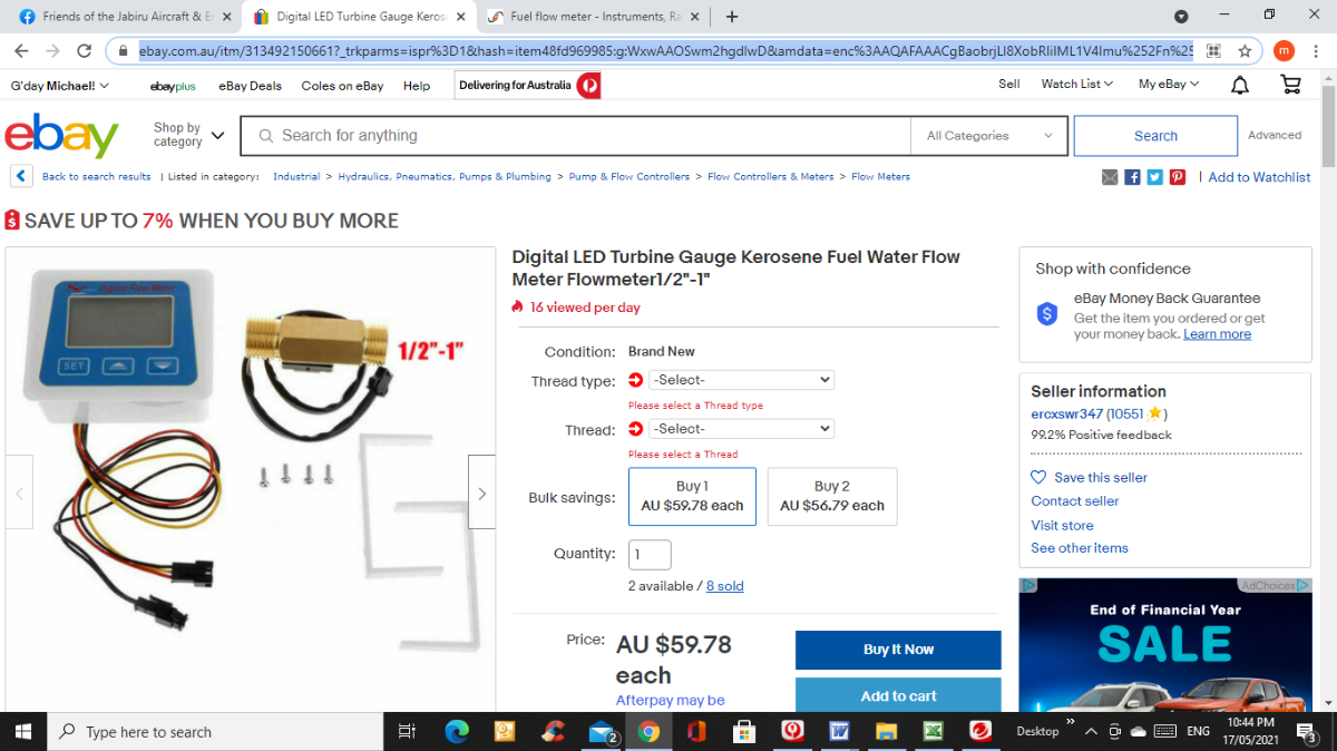

Blueadventures Posted May 16, 2021 Posted May 16, 2021 49 minutes ago, Paul davenport said: Thank you all just the info . Steam gauges fitted so it’s a stand alone gauge I will investigate FC10 I have a friend that has a FC10 and red cube fitted this annual; we were planning to run engine today but have put it off until Thursday or Friday afternoon. Will let you know how it goes.  I have seen cheap about $60 ones on ebay that may give an indication of flow; I have no idea of quality. Cheers

Blueadventures Posted May 17, 2021 Posted May 17, 2021 44 minutes ago, cherk said: if its for a 19 reg A'ft  https://www.futurlec.com/sensor/gasflowmeter.shtml Similar to the one I was mentioning above.Â
