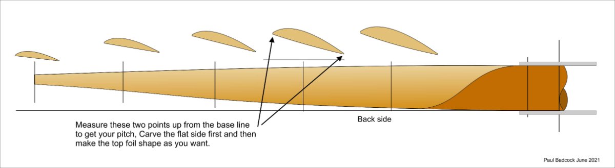

Aero28 Posted June 15, 2021 Posted June 15, 2021 This is how I do it ,I haven't flown behind one yet but this is an easy way to carve them. 1

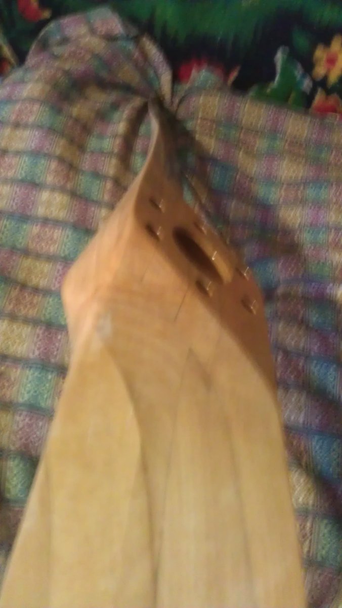

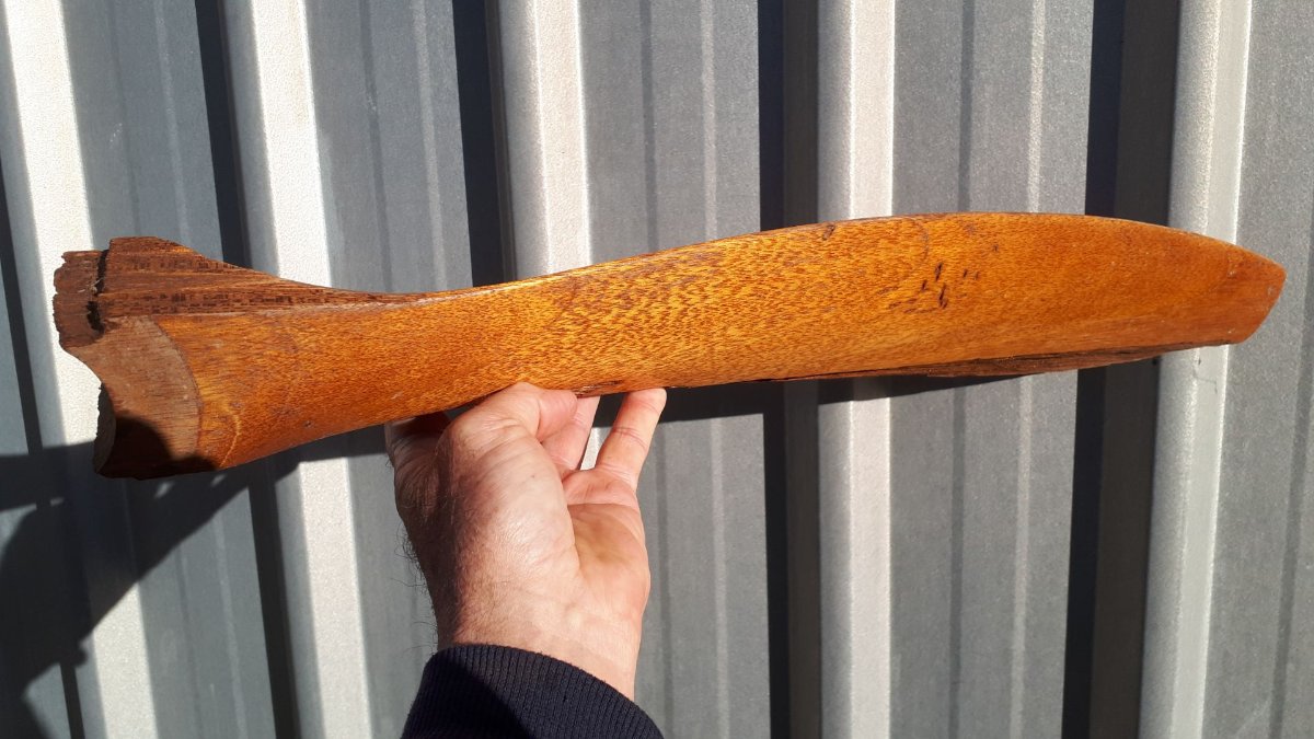

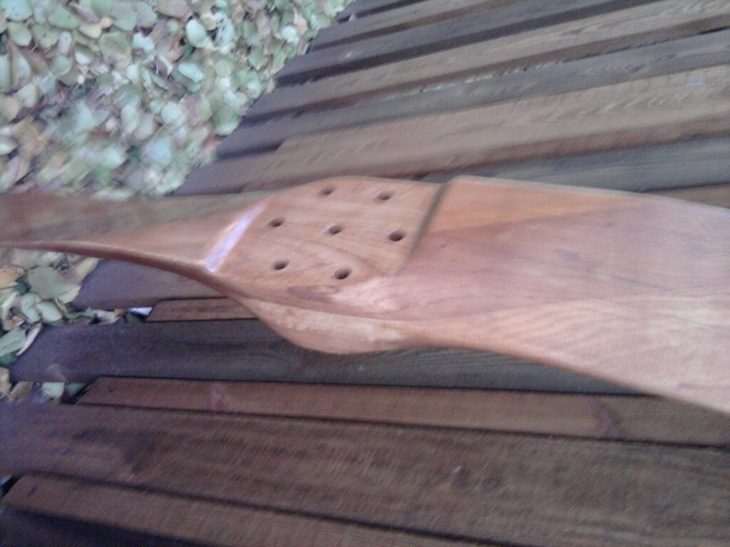

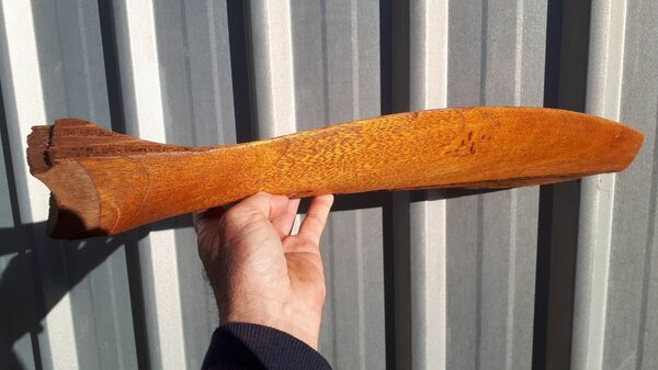

Thruster88 Posted June 19, 2021 Posted June 19, 2021 The propeller disintegrated on my Skycraft Scout just after takeoff, only ever found the one blade. Found it in the shed just now, it is smaller than I remembered. There is almost no thru grain because the prop hub bearings were inside the prop. 1 1
facthunter Posted June 19, 2021 Posted June 19, 2021 That's something to watch out for and a trap with wood. Some timber s are fissile (split easily). Nev
Old Koreelah Posted June 19, 2021 Posted June 19, 2021 I guess that’s why several laminates are normally used.
Marty_d Posted June 19, 2021 Posted June 19, 2021 That one doesn't look laminated at all. Was it carved from a single piece @Thruster88?
Thruster88 Posted June 19, 2021 Posted June 19, 2021 9 hours ago, Marty_d said: That one doesn't look laminated at all. Was it carved from a single piece @Thruster88? Yes it is laminated, you can see one just above my hand. The wood is very soft, similar to the wood used for skirting boards. 1
facthunter Posted June 20, 2021 Posted June 20, 2021 The holes in the hub give it no chance of doing the job. Sheet carbon fibre between the laminates in the hub area? Nev

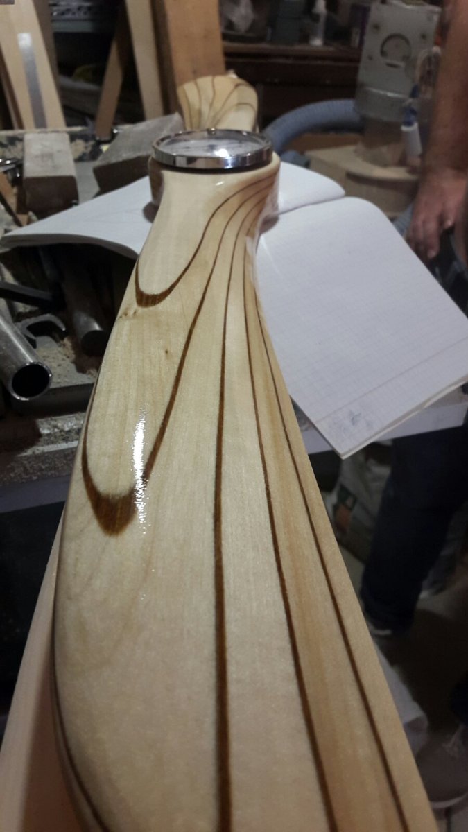

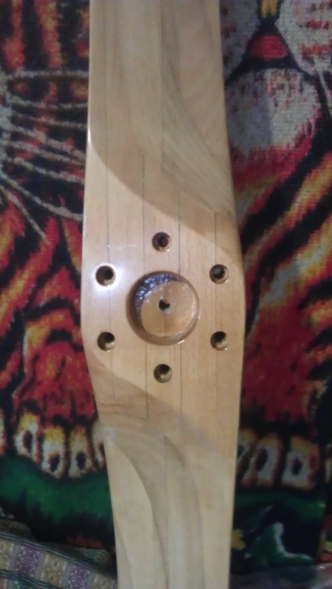

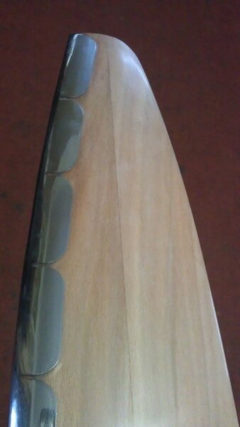

meglin Posted August 11, 2021 Posted August 11, 2021 This is a very difficult production. Dust, noise, toxic fumes. Hard wood varieties are very difficult to process. We usually use beech, oak, ash. Oak forms small needles that dig into the skin. At the finish, we must paste over fiberglass to exclude the influence of humidity. The blade edge is necessarily protected by a stainless steel strip. The quality depends on the hands of the master, on the wood, on the temperature in the room and the humidity of the wood, on the quality of the adhesives. We use only epoxy glue with maximum strength. All this increases the cost of the final product, but allows you not to worry in harsh operating conditions at temperatures from -50 to +50 degrees Celsius. For Jabiru engines, we have produced many samples of propellers with a diameter from 49 to 59". And we have achieved good performance indicators. But there is a factor that completely cuts off this business. At the request of the EU, our post office has limited the dimensions of parcels to 41'. Only very expensive courier services remain. For remote countries, there is only one way out - the use of composite propellers with especially strong carbon blades. The saber-shaped shape of the blades significantly reduces noise and allows the use of propellers with a diameter of 63.8". The thrust increases, vibrations decrease, there are no deformations of the blades from temperature and humidity changes. They are placed in a small box and can be delivered for a reasonable fee by regular air mail. 2 1 1

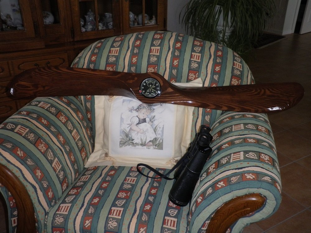

meglin Posted August 11, 2021 Posted August 11, 2021 In our entire history, we have never encountered a rupture of a wooden propeller. This is physically impossible, because the margin of safety is huge. There may be a longitudinal stratification due to poor-quality gluing of layers, such cases can be 1 out of 1000. But transverse destruction - never. Perhaps the propeller was intended for scenery, like these? 2
