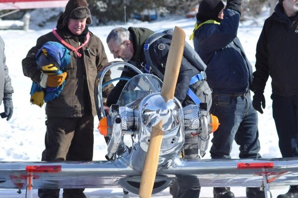

I have a quetsion about the use of circular or rectangular cross section gasket bead.
I want to push some silicone etc gasket bead in the fins on the top  couple of mm of the fins (so not to obstruct the available fin area more than necessary).
(why- because there is little.no clearance  for flat sheet on the outside of the fins in the region- so a pushed in bead an option if I cannot fit 2 thou SS sheet
Is a circular bead goes to have better retention than a rectangular cross section cord ? it would be secured with a little suitable adhesive here and there.
suggestions. comments ? - intended use (orange bead below) and the small gap I have to work with (that reduces when it gets hot !)
-glen

Could you explain what you are trying to achieve. Is this a Jab engine? Are you using the Jab Plenum or making your own?
Are you trying to seal the gap between cylinders?
For cooling efficiency you need the air to be going between the fins, from the top, high pressure side to the bottom, low pressure side and not getting through without close contact with the fins.
if you go to that post I referred to above, with a bunch of photos, that specific post, not the whole topic, you will see what I mean
In any case, the first post I made here has the information needed to for the question.....
Then in the absence of further information, the answer is: “it depends”. Why would you use stainless steel instead of alloy or fibreglass? While you need to constrain the edges of a baffle for structural reasons, why try and connect it to a (vibrating) engine? It won’t stay connected for long. What’s wrong with silicon baffle seal  material like everyone else uses? Are you solving a problem that doesn’t exist?

I am seeking to block airflow OUT of the fins. In some areas I can use a sheet of metal.
In the deeper fins I can push into between the fins silicone gasket bead. jam it it.  can apply a few spots adhensive every inch or so.
Now, the question is- will round or rectangular bead lead to better retention? The idea is that I minimise the protrusion into the fin area. a wide, and minimally deep rectangular bead might provide reduced protrusion compared to a round bead.
The round bead though may have a smaller contact area, and this may  enhance retention due to a higher pressure per square mm.  the bead will deform oval, and thus will prodrude a fair way into the fin channel, and also has to be recessed into the fin because I need a flush external surface.
-glen
Square,
 it will hold better, and if you use oversized silicone, you can Sstretch it, to fit tighter inbetween the fins ,.
Just my idea.
spacesailor
OK ! thanks for the suggestion. I will endeavour to get some  square /rectangular stuff . as well as round.
It's tizzy and a pretty bodgy fix. There you have it. Pushing air or any fluid through confined spaces and knowing flows is a back art. I love your work but if this is the fix, just what was the question?  Nev
the question was round or rectangular... most areas I will use 2 thou SS shim  for the cover. or some alloy if temp comp is a problem.
but some small bits I may want to optimize and pushing in some silicone bead  is easier than shaping bits of metal.
