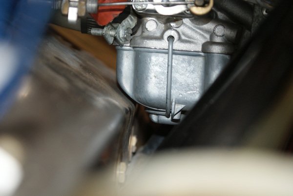

ideas ? (short of lifting the engine...)
Edited by RFguy
Can you get to the flange nuts and pull the carby away; I normally turn the carby upside down on the bench and measure float position with a vernier gauge.
Hi Turbs
it may be possible to . yeah,
I looked at sliding it forward in the rubber coupling to the intake manifold but that only wins a extra couple of mm.
I’ve done a few......engine crane strap onto the prop flange the jack it up till the nose wheel just touches the ground. This will put a force onto the rubber mounts giving you plenty of room
Ken
Hi Ken
OK great idea. right, take up the compliance in the rubbers.
