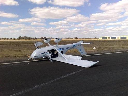

Ben Longden Posted April 6, 2008 Posted April 6, 2008 The pilot of a light plane walked away with only a bruise after his Jabiru J160 crashed on landing at Echuca earlier this afternoon. The pilot, who was the sole occupant said it was a normal approach in light conditions. The low front edge of the nosewheel fairing contacted the bitumen which stopped the nosewheel turning, which in turn caused the plane to flip onto its back. Ben [/url]
Guest aircraft1 Posted April 6, 2008 Posted April 6, 2008 How can a wheel spat rubbing on the ground or front tyre cause a plane to turn over on its back ?

Guest Decca Posted April 6, 2008 Posted April 6, 2008 Aircraft1; rubbing on ground or tyre is ok, but when spat locks between wheel & ground, the nose wheel stops but the a/c keeps going, dare I sat it, due to its inertia, & wont stop until the top surface hits the runway, upside down & facing the wrong way. Regards, Decca.

BigPete Posted April 6, 2008 Posted April 6, 2008 Well - it wasn't that bad a landing - the pilot flared a bit early and the aircraft landed firmly on its main wheels and bounced back into the air. Unfortunatly it then came down on the front nosewheel thus sandwiching the spat between tyre and the bitumen runway. The 'plane then nosed over (shattering the wooden prop) and skidded down the runway on its engine cowling and left wingtip. As it came to rest it finally flipped onto its back. (yes Decca - thats me - talking to the law). and no Geoff - not my 'plane. regards

bushpilot Posted April 8, 2008 Posted April 8, 2008 Amazing how strong those Jabs are! :thumb_up: Will be interesting to see the damage report.. Bad luck tho..
