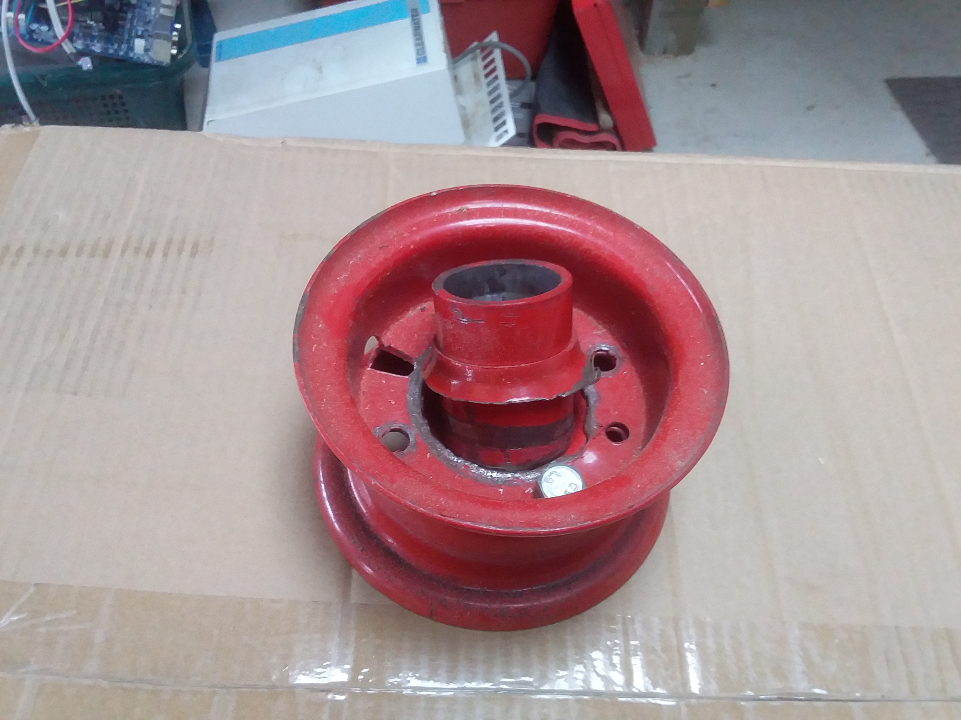

graham brown Posted September 8, 2020 Posted September 8, 2020 After 150 hours on my Sierra the nose wheel decided to split at the hub. Luckily the fork kept it contained and no damage. I decided to put a Matco 4 inch nose wheel on and all that was needed was a new axle as the bearings are .675 in rather than 15 mm. All went well until the test fight where nose wheel shimmy occurred. So violent it tore 2 in slots in the spat attachment holes. Took the spat off and decided to overhaul the leg. Mine has the small diameter leg where any wear will show up as sideways movement. I redrilled the attachment holes and reamed them to new bolts. No movement. Next time I will go to the bigger diameter leg. All back together. Tightened the damper so plenty of friction. All ok but still not real sure on landing. Next move was to lower the tyre pressure from 30 psi to 20 psi. This made the treads all touch where before only the centre tread touched the tarmac. It now feels great. The old tyre was flat profile where the new one is more rounded. Spat will go back on next week. Hope this helps all who need to replace their nose wheel. I will post photos next week. 1 2

graham brown Posted September 9, 2020 Author Posted September 9, 2020 I will post pictures later but the old one was pressed steel and cracked around the weld to the hub. The new one is aluminium and in 2 halves bolted together and I’m a lot more confident with this type of wheel.

onetrack Posted September 9, 2020 Posted September 9, 2020 I think that wheel is a little different and more durable than a wheelbarrow wheel! For a start, wheelbarrow wheels are not welded, they comprise two sections of light pressed metal bolted together over a stand-alone centre hub section. Wheelbarrow bearings and axles are only half the diameter of the wheel that Graham has posted the photo of. Â https://www.nomaallim.com/wheelbarrow-tire-repair.html
graham brown Posted September 9, 2020 Author Posted September 9, 2020 The old wheel had proper bearings which you had to fit and discard the roller bearing that came with the wheel. It looked like a wheelbarrow/ trolly wheel but was better than it looked. The crack that developed was probably a flaw in the weld that propagated around. They not available anymore so the upgrade to the alloy wheel is the way to go. Ray says he can design a completely new fork and wheel which would also be a good option but it would need testing. 1
facthunter Posted September 10, 2020 Posted September 10, 2020 That weld hasn't penetrated. Shimmy happens to a lot of nosewheels, and tailwheels too. A damper might be a good idea. Bit serious when it happens. Nev
