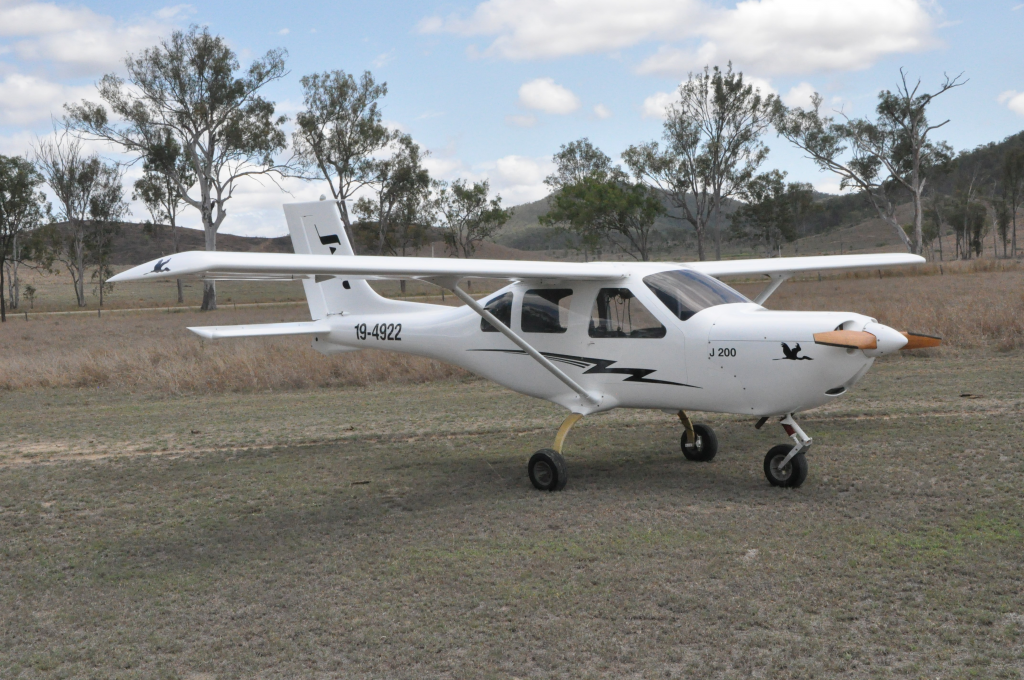

RFguy Posted August 20, 2020 Posted August 20, 2020 Seems 200 is a good first plane, and 19- ripe for experimental work. (aside from 19- LSA, SK) Why are all the J200s I can find all 19- ? were they all factory kits ? Can someone please point me to a POH for the J200, Jab site only lists current stuff. -glen.
horsefeathers Posted August 20, 2020 Posted August 20, 2020 How's about this one https://www.aviationclassifieds.com.au/listing/5737
Kenlsa Posted August 20, 2020 Posted August 20, 2020 Technically only the original builder of a 19 registered and built aircraft can modify it as they are the one who "certified the build" to RAaus when they submitted the compliance paper work.. Unless you can convince the original owner to modify it you are stuck. You can not learn to fly in it as you did not build it for your own "educational purposes". You have to have all training in a 55, 23 or 24 reg aircraft. I know.......who is going to know? but these things have a habit of biting you somewhere down the track. I have seen the process when the question arises of unauthorized modification rears its ugly head. Ken 1
Kenlsa Posted August 20, 2020 Posted August 20, 2020 The J200/400 were more aimed at the VH market as they suffer from higher stall (over 45kts) speed and lower useful load of about 195 Kg when built as an RAaus A/c at 544Kg. So the 230 was produced, more wing area, to get to 45 kts and 600Kg. I do realise that there are some old J400 converted to RAaus and sneaked in at 600kg but they were self certified and may not actually pass the stall speed at Max AUW if ever tested. It is not a perfect world. Ken
RFguy Posted August 20, 2020 Author Posted August 20, 2020 Technically only the original builder of a 19 registered and built aircraft can modify it as they are the one who "certified the build" to RAaus when they submitted the compliance paper work.. Unless you can convince the original owner to modify it you are stuck. You can not learn to fly in it as you did not build it for your own "educational purposes". You have to have all training in a 55, 23 or 24 reg aircraft. I know.......who is going to know? but these things have a habit of biting you somewhere down the track. I have seen the process when the question arises of unauthorized modification rears its ugly head. Ken HI Ken. Yes that's what I understood from the RAaus technical manual which has great slabs of this in boilerplate.... You have to build it yourself. Thanks for confirming my understanding. There is something about builder / owner variations but this was even more murky. Yes who is going to know....until there is an accident.... I'll end up getting a 24- J120 for starters most likely. affordable and will help me get some feeling for what I really want to do. Seems I cannot get away from having to build a kit, and get tit RAaus authorized and signed off for op in CTA. and 500-1000 hours to build an aircraft I do not have for the stepping stone to modify aircraft for engine instrumentation purposes . "Modify" of course is a variable definition. Spock would not like that.
