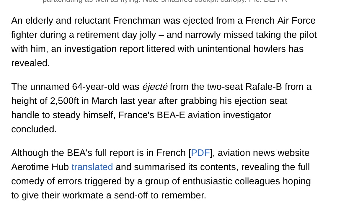

fatmal Posted April 14, 2020 Posted April 14, 2020 https://www.theregister.co.uk/2020/04/09/frenchman_ejected_fighter_jet_retirement_jolly/ This reads like a comedy of errors - luckily no one killed, but I'll bet a few French airmen & ground crew got a bollocking! Check out the comments for some insight (and quite a bit of humour!) mal 1 1

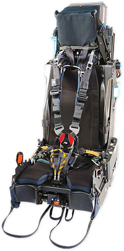

willedoo Posted April 16, 2020 Posted April 16, 2020 (edited) This is the MB MK.16F Rafale seat. Edited April 16, 2020 by willedoo

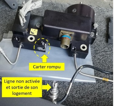

willedoo Posted April 16, 2020 Posted April 16, 2020 This photo is up on a few news sites. It will interest them to find out why the front seat didn't follow the rear one out.
M61A1 Posted April 16, 2020 Posted April 16, 2020 https://theaviationist.com/2020/04/09/report-released-on-french-rafale-passengers-accidental-ejection-reveals-both-human-and-technical-failures/ The reason for the failure of the pilot’s ejection seat in the escape sequence was reported as, “The explosion [from the initial rear seat ejection] ruptured the casing of the sequence selector supposed to trigger the pilot ejection seat.” Usually after a successful egress the crew owe the armourers a carton. I don't know how this will pan out as the failure actually worked in his favour.
willedoo Posted April 16, 2020 Posted April 16, 2020 Martin Baker will be looking into that one; they don't like their reputation being damaged. Faulty part perhaps. Technically, they should ground all aircraft using those seats until the fault is fixed. First thing would be to figure out if there's a batch fault or just an individual situation. There's always the possibility the sequence selector was only needed for a two seat sequenced ejection and the pilot, if need be, could still initiate his own egress after the fact.
M61A1 Posted April 16, 2020 Posted April 16, 2020 Martin Baker will be looking into that one; they don't like their reputation being damaged. Faulty part perhaps. Technically, they should ground all aircraft using those seats until the fault is fixed. First thing would be to figure out if there's a batch fault or just an individual situation. There's always the possibility the sequence selector was only needed for a two seat sequenced ejection and the pilot, if need be, could still initiate his own egress after the fact. Yes, it's my understanding that all Rafales were grounded because of the seat issue. I think it may have been in the linked article or in the comments for the same article. 1
willedoo Posted April 17, 2020 Posted April 17, 2020 My seat experience predates the MK.16 by a few decades, so I'm not overly familiar with it. But looking at the photos, it appears to have what I'm assuming might be the auxiliary pull handle on the starboard side of the seat pan (yellow & black painted). Going into negative G with a loose harness, he would be more likely to grab the sides of the seat pan rather than the main handle between his legs. So I'm thinking that's what he's done when he fired it. There will be a lot of people in trouble over this one. It beggars belief that they put a newbie in the back seat without ensuring he was strapped up properly. And taking off with the helmet undone. Worst case scenario would have been if he only had the chin strap loosely done up which could have broken his neck. Makes one wonder if that pilot's fighter career is over. He might end up flying transports after this one. He would still have to shoulder responsibility for the unpreparedness of his backseater. 1

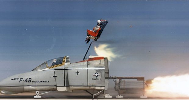

willedoo Posted April 18, 2020 Posted April 18, 2020 Looking at some of the MB test bed photos, that Rafale would have had a lot of burn damage in the rear cockpit. The newer generation of seats fry the cockpit much more than the older types, due to the rockets igniting while the seat is still partially inside the aircraft. The upside down twin gun system wouldn't appear to add to it much, due to most of the flame exiting at the top of the cockpit. But the flame from the rockets would have done a lot of damage. Photos below are of the F-35 test bed which also has a MK.16 variant, but the basic structure, gun & rocket systems are much the same as that on the Rafale seat. This photo gives a good view of the twin guns still firing inside the cockpit. This photo is of a MK.7 in an F-4 Phantom test rig. A fairly standard three stage telescopic gun and rocket pack. You can see the seat and inner tube has exited the gun's intermediate tube with flame expired and totally contained within the gun. In this photo, the inner tube has only just left the intermediate tube and there's only residual black smoke from the secondary charges exiting. It has enough extension to clear the cockpit before the rocket pack ignites, causing much less burn damage. Much harder on the back though, compared with the Rafale/Eurofighter/F-35 seat. 1
onetrack Posted April 18, 2020 Posted April 18, 2020 I'm a little surprised they don't use a large compressed spring to initiate ejection, then ignite the rockets, once the seat is outside the cockpit.
willedoo Posted April 18, 2020 Posted April 18, 2020 I'm a little surprised they don't use a large compressed spring to initiate ejection, then ignite the rockets, once the seat is outside the cockpit. It might be a bit hard on the back, similar to the gun charges. The early Martin Baker had a single stage gun with only the main charge at the top. I think the charge varied depending on the height of the tail fin to clear. Either 50 or 60 fps, and they would get to over 20 G's. In later seats, charges went up to 80 feet per second on some aircraft, but using secondary charges to stagger the blast force rather than one big bang like the early seat. Low tail, twin boom planes like the Vampire didn't need a big charge, whereas high tails like the Mirage would need a much bigger charge, so that's where breaking the force into stages was important. The idea of the rockets is for zero/zero or low altitude ejection as the rockets take the seat up about 200 feet; enough to get a decent chute canopy. Rockets are also a much softer ride than the explosive charges of the gun. I'd guess the early firing in cockpit of the rockets on the MK.16 seats would be all about saving the pilots back. Historically, the main injuries received were spinal. The RAAF has has 80+ ejections and about 30% of those caused spinal fractures. Most were just hairline cracking from the compressive forces; usually a case of the pilot complaining of ongoing back pain. Only in one case did a broken vertebrae impact the spinal cord and luckily it didn't cause any paralysis. 1 1

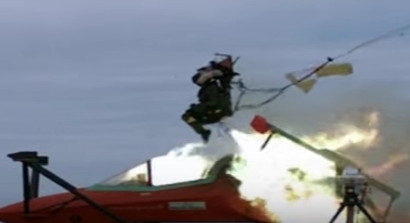

willedoo Posted April 18, 2020 Posted April 18, 2020 What a wild ride that would be? You're not wrong there Flightrite. With all that flame, you would want to make sure the fly on your nomex suit was zipped up tight. It's interesting in those photos to compare photo #1 ejecting at the rearward sloping seat angle, and #2 how quickly the rocket ignition pushes the pilot forward into an upright position.
