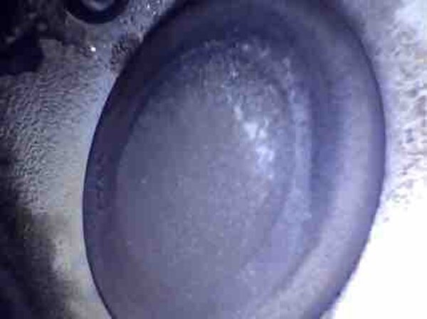

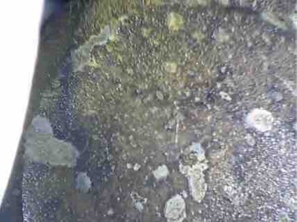

brinykraut Posted June 25, 2020 Posted June 25, 2020 Agreed, Planey. Just trimming it back a smidgeon, within tolerance. Yesterday arvo I poked my inspection camera down the plug holes. Wish I hadn't; up close, the encrustations on top of the piston look like massive geological structures. I've been religiously using AvGas for a decade, mostly for it's known quality, but would love to get away from lead. Is there any additive I can use to clear those internal deposits? Yessir, I had the same reaction after inspecting my pistons during the first 100 hr check, more crud than I expected, anyway. Exhaust valves have me guessing even more. I have started using TCP: TCP Fuel Treatment, 1 Quart | Alcor, Incorporated A very popular additive up here, recommended by A&P's as well. I think it's more of a preventative to build-up rather than a cure, but I will be monitoring closely over the next inspections. 1
facthunter Posted June 25, 2020 Posted June 25, 2020 That sort of build up can cause incandescent spots and pre ignition. It's not easy to remove either but I think I would be doing something about it. Usually some of the build up is DUST that bonds with some carbon. Nev 1
Flightrite Posted June 25, 2020 Posted June 25, 2020 I operate a 80gee gee solid Jabby donk and I use 95 RON with a flashlube mix, 480 hrs, the Pistons valves etc are whilstle clean as far as I can tell/see? 1
skippydiesel Posted June 25, 2020 Posted June 25, 2020 Ag I've been religiously using AvGas for a decade, mostly for it's known quality, but would love to get away from lead. Is there any additive I can use to clear those internal deposits? Its called ULP - nice clean burn. Minimal deposits. Minimal pollution. Whats not to like ? 1
