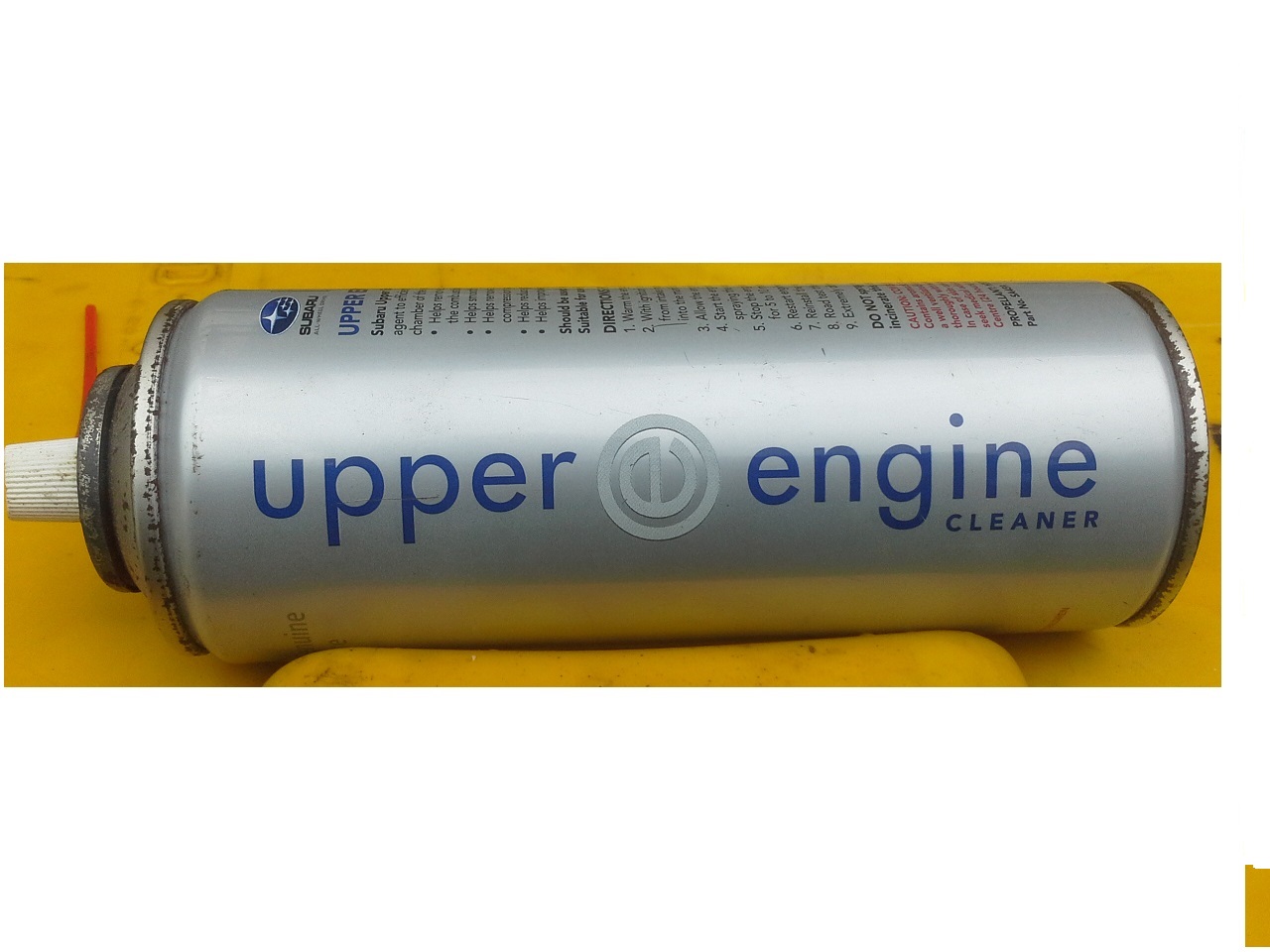

spacesailor Posted June 10, 2020 Posted June 10, 2020 This "can" really cleaned my Test engine, Ford 6 pot iron head was clean of all coke-deposits. ran like a watch. after I took the head off to replace a dropped valve, when doing the valve-stem seals, I wasn't intending to remove the head but ended up that way. spacesailor 1 1
