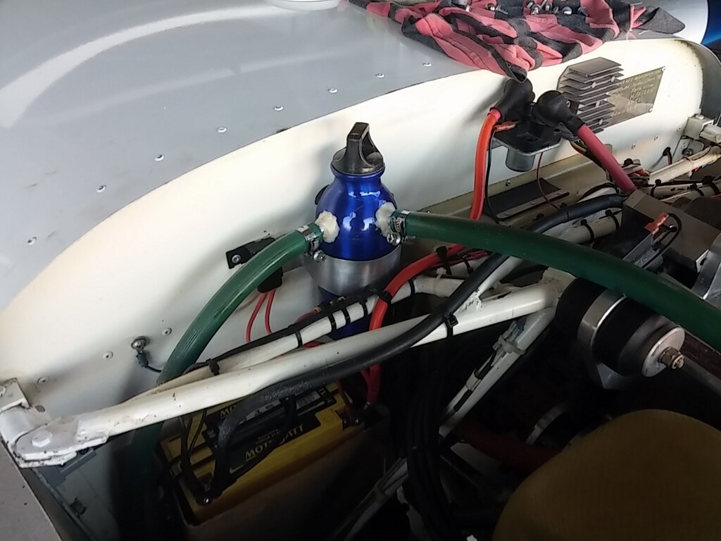

I originally had a fibreglass oil catch bottle and it got a leak in it. When I emptied it there was only condensed water vapour but it was brown & smelled like oil/fuel mixture. Then the leak appeared unbeknown to me & the stuff that was in it leaked down the firewall & had solidified into sticky greasy goo that eventually went hard. It was really hard to remove. Degreaser wouldn't budge it but after several attempts I got rid of most of it. I then got an aluminium drink bottle & epoxied inflow & outflow tubes. The good thing is that it has a screw in top which I can take off to have a look at what is in there. I have another 4 hours before my 100 hourly so will check then advise what I find. I don't top up between oil changes so the engine isn't throwing any oil. I have heard that if you overfill a Jabiru engine it will throw the excess out into the catch bottle.
Aircraft engines don't use any recirculation of engine vapours thereby eliminating any possible problems. If you didn't have one the underside (and firewall in my case) would get pretty dirty.20190710_144412.thumb.jpg.53744f9226960b60b932bf9247c31dcc.jpg
