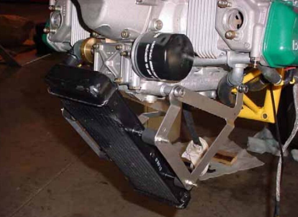

Marty_d Posted September 7, 2019 Posted September 7, 2019 Hi all, Has anyone fitted the Rotax 912 water radiator longitudinally on an angle under the front of the motor - like the picture attached? Just wondering what size those rubber mounts are. I see Mackay Rubber have them in various sizes. I know that the threads are M6, guessing the radiators are threaded M6. Any idea of the diameter and height of the rubbers, and the spacing of the mounting points on the radiator? Thanks! Cheers, Marty
M61A1 Posted September 27, 2019 Posted September 27, 2019 Mine is mounted similarly, but in a different spot. I used rubber grommets with top hat bushes. Cheaper than Mackay vibration isolators by a long shot and are captive if the rubber fails for any reason. Or you cab get these in M6 male/male , male/female or female/female https://www.ebay.com.au/p/1838342580 Don't know if you have a radiator yet, but I got mine from the Savannah agent for just over $200, a lot less than Rotax.

Blueadventures Posted September 28, 2019 Posted September 28, 2019 The rotax ones are about $25 each. Most you see around town are 7mm thread. Ebay ones may be ok. Cheers

skippydiesel Posted October 28, 2019 Posted October 28, 2019 Hi all, Has anyone fitted the Rotax 912 water radiator longitudinally on an angle under the front of the motor - like the picture attached? Just wondering what size those rubber mounts are. I see Mackay Rubber have them in various sizes. I know that the threads are M6, guessing the radiators are threaded M6. Any idea of the diameter and height of the rubbers, and the spacing of the mounting points on the radiator? Thanks! Cheers, Marty [ATTACH]40995[/ATTACH] On my aircraft they are called "Silent Blocks" (vibration isolators) whatever you call them they are available in a wide range of sizes and from a similarly wide range of suppliers . They can come in male/male, male/female, female/female threaded sections. I used mini ones to mount my instrument panel. 1
