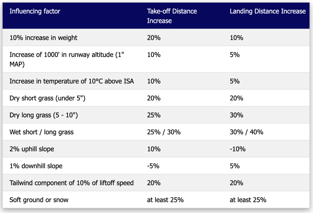

Garfly Posted July 1, 2019 Author Posted July 1, 2019 I guess the test flying could be done under any atmospheric conditions and any load if the results are adjusted for all the variables: Source: Factors Influencing Landing & Takeoff Performance of Aircraft

aro Posted July 2, 2019 Posted July 2, 2019 More information about how accurately they flew the book figures would be useful. E.g from an online POH the C182 performance calculation is based on an initial climb at 58 KIAS. If you let the speed build past that it will use a lot of extra runway. Allowing the speed to build to 66 KIAS would account for at least 30% extra ground roll compared to 58 KIAS. (66/58 squared, which assumes constant acceleration. Real life is probably worse) Likewise the landing figures specify heavy braking. They said they used moderate braking which could easily account for 30%. Another thing to be aware of with braking - braking early when you are still going fast counts the most. Heavy braking when you have already slowed down doesn't make as much difference - the runway is already behind you. Having said that, the book figures are very short and most of us would be challenged to achieve them. 433 feet is 132 metres. Add 50% and you are still below 200m, which would make you stop and think in a 182 I reckon... 2
