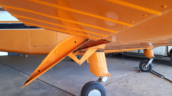

Thruster88 Posted April 18, 2019 Posted April 18, 2019 We all know from our BAK that wings stall at about 16 degrees aoa regardless of airspeed. So when we lower 30 degrees of flap to zoom over an obstacle and the main wing is at say 10 degrees aoa, why don't the flaps stall and not provide much lift only a lot of drag ?.
Soleair Posted April 18, 2019 Posted April 18, 2019 So when we lower 30 degrees of flap to zoom over an obstacle and the main wing is at say 10 degrees aoa, why don't the flaps stall and not provide much lift only a lot of drag ?. Some flaps do provide mostly drag and little lift at high angles of deflection. But to answer your specific question, the effective chord line for AOA reckoning is found by an imaginary line joining the T/E of the wing to the centre of the L/E nose radius. In the case of flaps, the line from the T/E of the flap to the L/E of the wing would be less than the 30º flap angle. 1
