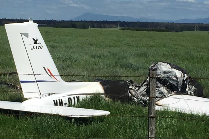

Admin Posted October 21, 2018 Posted October 21, 2018 A senior Tasmanian police officer has been identified as the pilot involved in a single-engine plane crash in Northern Tasmania. Inspector Darren Hopkins, 51, is in a critical but stable condition after suffering severe burns to 25 to 30 per cent of his body when he crashed into a paddock. Tasmania Police said a fire broke out in the cockpit while the plane was mid-air, but Inspector Hopkins was able to land the plane, exit the aircraft and phone emergency services, who were called to the scene at about 11:20am on Sunday. Police said the plane crashed near Westwood Road, Hagley, about 30 kilometres west of Launceston. The recreational pilot was taken to Launceston General Hospital with serious injuries before being flown to the Royal Hobart Hospital by the Westpac Rescue Helicopter. IMAGEInspector Darren Hopkins is in a serious but stable condition after suffering severe burns in the crash.(Supplied) Commander Brett Smith said it was a tough day for Tasmania Police. "It certainly hits home but we're just pleased to see that Darren is stable and is holding his own," he said. "It does impact our members and we're just very, very thankful … it could very well have been much worse. "It appears to be remarkably lucky that Darren was able to land the plane in the conditions." Local dairy farmer Andrew Johnston said he watched the plane from about 2 kilometres away before seeing a "big puff of smoke". He said he saw the plane flying at an altitude of about 80 metres, resembling a crop duster. "It was just turning, like a spray plane would doing the crop, just turning around … and then a big puff of smoke," he said. "I didn't think that [the smoke] was the plane, though — I thought it was someone burning off." "It's not the time that a spray plane or a fertiliser plane would be out because the ground's all dried out. "So it was a bit unusual; it caught my eye. "I don't know if he was looking for a paddock to land in." Tasmania Police said the cause of the fire was unknown and the Australian Transport Safety Bureau would investigate the crash.
cooperplace Posted October 22, 2018 Posted October 22, 2018 as a jab pilot, I'd really like to know what caused a fire to break out in the cockpit.
Jabiru7252 Posted October 22, 2018 Posted October 22, 2018 We had a Jabiru J170D at my flying club catch fire and burn to nothing while sitting in a hangar. Was 24 hours or so after its last flight. No explanation as far as I know.
turboplanner Posted October 22, 2018 Posted October 22, 2018 as a jab pilot, I'd really like to know what caused a fire to break out in the cockpit. There can be quite a few reasons with a custom build aircraft; fuel leak, oil on the manifold, fitting an accessory without a fuse, disturbing wiring while installing something etc. These days the most likely suspect for a big fire is thermal runaway in one of the non-standard battery types people have been fitting. Thermal runaway starts like a mini explosion, and this description fits the witness description (although not necessarily the cause, just a possibility). Thermal runaway also occurs in electronic components like GPS, phone, tablet etc. The more important aspect is to be ready to act fast to get the aircraft down on the ground; with a fire in the engine bay it may be possible to side slip on the way down so the flames are directed away from the cockpit, even blown out. In the case of a fire which gets into the cockpit, you couldn't get better than what this gentleman did. Hopefully he may be able to share the cause. 2
onetrack Posted October 22, 2018 Posted October 22, 2018 I'm wondering if he had a lithium battery aboard somewhere? Looks suspiciously like a thermal runaway that is a classic Lithium fire. 2
Head in the clouds Posted October 23, 2018 Posted October 23, 2018 By the sound of what the dairy farmer said - that he was circling around low level "like a spray plane" and all seemed okay other than that, and then a big puff of smoke (big enough for him to think someone was burning off) perhaps he might have hit powerlines. I think the final burnt out result looks more like the fuel eventually caught alight, rather than a battery thermal runaway. I had one of those with a helicopter and the fire was quite intense but localised. 1
