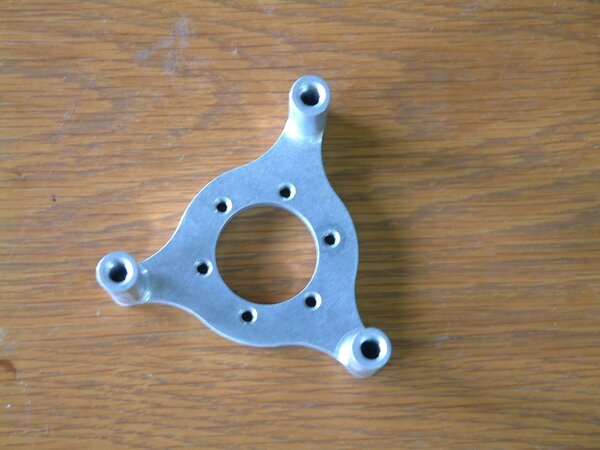

At that point where while cleaning up old drum brakes one gets to pondering is it worthwhile changing to discs, seen a few rotor and disc set ups on pit bikes and mountain bikes but offsetting the rotor from the rim will require a set of these three prong ally offsets, but where can they be obtained.
Any ideas thanks

You can only obtain those ally standoffs from Belite Aircraft, as Belite get them custom-made locally.

Thanks Onetrack, I have seen 3 prong offsets around well before Belite made those I posted, that's where I scored the pics, thought maybe something local was available or maybe off a quad or something, my mechanic races gocarts and said the pattern was the same off old carts from the 60's, Onetrack you wouldn't happen to know the centre to centre of the Belite offsets by any chance, my centres are 3 1/4

AussieB1rd - Sorry, I have no dimensions or specifications for the Belite standoffs - try emailing James Weibe at Belite, I believe he's a quite a helpful guy.
