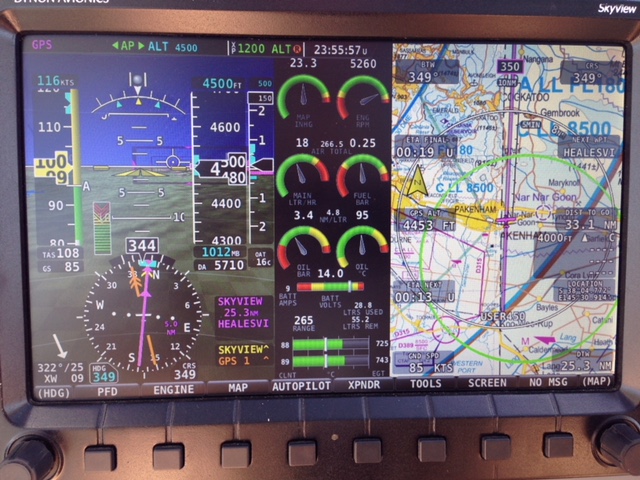

As for L&R tanks draining unevenly, my Eurofox tanks have clear plastic tubes as an extra visual indication of fuel remaining in each. Over a 3+ hour flight with both fuel valves open, invariably one tank drains somewhat more than the other - and not always the same side. I’m mostly on autopilot on such long legs, so the wings are consistently kept level. I’m not especially bothered, as I can easily see and rectify this in flight, but it is a quirk that puzzles me.
Is the ball precisely centered while on a/p? Your a/p may well fly you on a straight track, but it could do this with crossed controls.
  • Agree 2
  • Helpful 1
The slightest difference in vent pressure would bias the system. School aircraft like the gazelle can show marked difference in fuel level. I put it down to flying unbalanced. Nev.

This photo is typical of a cruise on autopilot - ball central, wings level - note wind aloft. I’m suspecting slight vent pressure variations. Tank usage differentials are usually less than 5 litres over 3 hours.
<5ltrs I wouldn’t even consider.
Remember if a large out of balance does occur then just feed in half a ball of skid and watch the transfer back.
